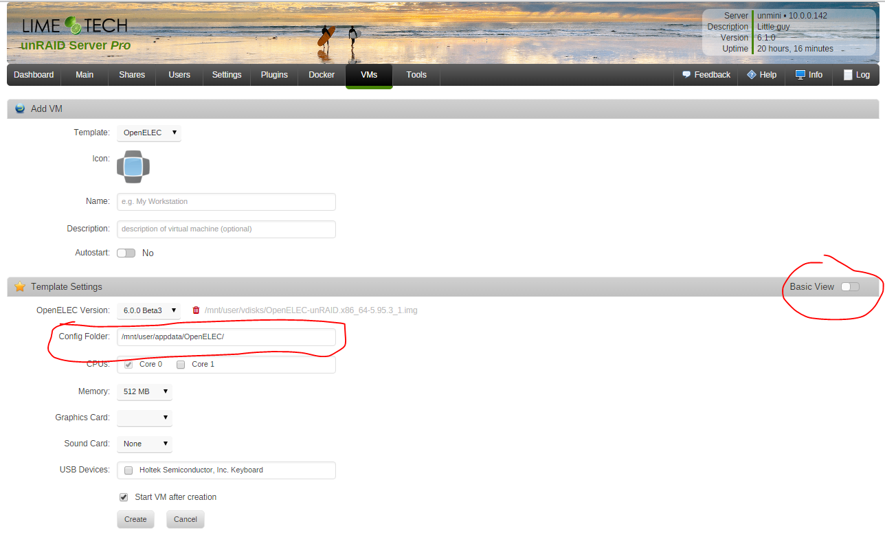

1.  When creating the VM you need to have "advanced view" enabled to see the "config folder" field.  I missed setting this and although openElec started I had various error messages on screen!
Not true.  See image attached.  You probably need to clear your browser cache.
