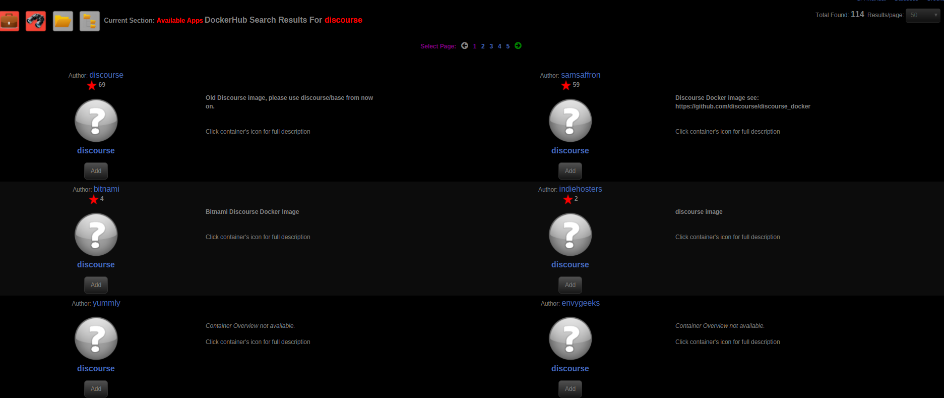

October 21, 201511 yr Try turning on dockerhub searches within community applications search for discourse and see what happens

July 26, 20179 yr 48 minutes ago, bdillahu said: I know this is a really old one, but anybody have a pointer to getting the Discourse docker loaded now? I tried Squid's suggestion above (adding DockerHub in CA), but it still doesn't find anything. Thanks! 114 results on a search for discourse
July 26, 20179 yr OK, duh... duh, and duh. Read the instructions, bdillahu. Sorry Squid, I was missing the "click here for further Docker results" right in my face. Edited July 26, 20179 yr by bdillahu Dumbness...

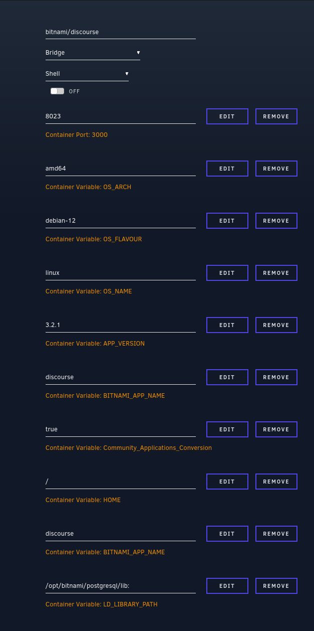

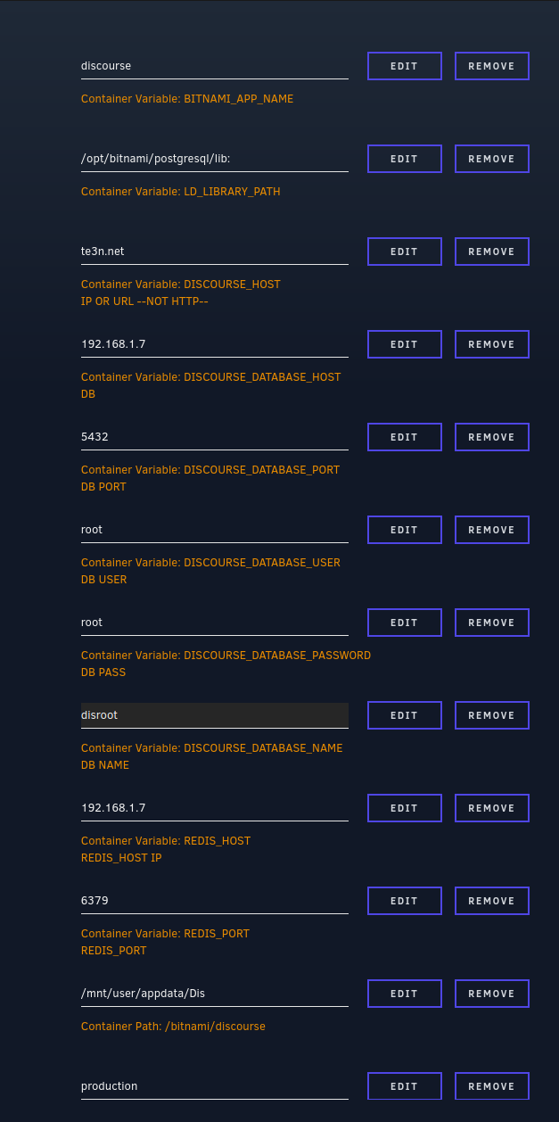

April 11, 20242 yr On 4/25/2021 at 6:21 AM, Zan said: I saw a youtube clip by IBRACORP on installing Discourse via an Ubuntu VM on Unraid and there was a comment about using bitnami's docker-compose to install it without using a VM, so I thought I'd give it a try, and I got it mostly working, it just needs some tweaks which I don't have the time for, to stop chromium (edge/chrome) from flagging it as untrusted. For anyone interested here were my steps: 1. Setup CNAME for discourse.<mydomain> 2. Change ddclient.conf to enable dynamic DNS for CNAME 3. Installed portainer docker through Community Apps, and docker-compose via pip from command line (and in unraid /boot/config/go for future re-starts) 4. I wanted to use gmail for SMTP for my discourse installation so created an app-specific password for Discourse via account.google.com 5. Made the following changes to bitnami's docker-compose.yml file: Changed port to - '3000:3000' Added /mnt/user/appdata/discourse prefix for all volumes (eg. redis_data -> /mnt/user/appdata/discourse/redis_data) Added the following environment variables for discourse and sidekiq services: - DISCOURSE_HOSTNAME=discourse.<mydomain> - SMTP_HOST=smtp.gmail.com - SMTP_PORT=587 - SMTP_USER=<my gmail login> - SMTP_PASSWORD=<app specific password> Added your reverse proxy docker network to discourse service networks: - proxynet Added the following to the end of the docker-compose.yml file to flag it as an externally-created docker network: networks: proxynet: external: true 6. Added discourse subdomain to swag subdomains variable to have swag create a new certificate for the subdomain. 7. Added the following proxy conf to nginx (/mnt/cache/appdata/swag/nginx/proxy-confs/discourse.subdomain.conf) for discourse (note that the IP address was hard-coded by getting the IP address for the discourse docker after first start, as I couldn't figure out how to modify the line #set $upstream_app discourse_discourse_1; in order to have nginx automatically figure out the IP address): ## Version 2020/12/09 # make sure that your dns has a cname set for discourse and that your discourse container is not using a base url server { listen 443 ssl; listen [::]:443 ssl; server_name discourse.*; include /config/nginx/ssl.conf; client_max_body_size 0; # enable for ldap auth, fill in ldap details in ldap.conf #include /config/nginx/ldap.conf; # enable for Authelia #include /config/nginx/authelia-server.conf; location / { # enable the next two lines for http auth #auth_basic "Restricted"; #auth_basic_user_file /config/nginx/.htpasswd; # enable the next two lines for ldap auth #auth_request /auth; #error_page 401 =200 /ldaplogin; # enable for Authelia #include /config/nginx/authelia-location.conf; include /config/nginx/proxy.conf; resolver 127.0.0.11 valid=30s; #set $upstream_app discourse_discourse_1; set $upstream_app 172.18.0.12; set $upstream_port 3000; set $upstream_proto http; proxy_pass $upstream_proto://$upstream_app:$upstream_port; } } Hope this helps anyone who wants to give discourse on their server a try. I'm trying to put together a site for a sport club and ultimately decided that discourse wouldn't suit my needs, so haven't bothered to https and proxy-conf issues that I came across. 2 years old but i need help please Edited April 11, 20242 yr by Tweak91

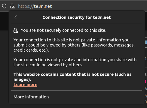

March 11, 20251 yr On 4/11/2024 at 9:24 AM, syko91 said: Way late to reply - I think this is because you have set up the nginx config for discourse.te3en.net , but you are accessing https://te3en.net (and telling the docker to instruct discourse that it is found at the root domain, not the host discourse). This is of course assuming you followed the other steps of setting up nginx/swag with ssl/letsencrypt.
