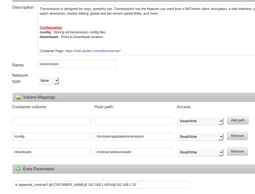

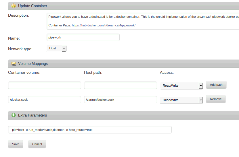

Very cool. Thanks for putting this together as it's exactly what I need. However, I'm having an issue getting it to work properly. I've read and reread everything with no luck.
Can you post a screen shot of your config?
Thanks again!
Here is a couple of screen shots of the configuration that is working for me.
Are you trying to set a static or dynamic IP?
I have the 'Nerd Pack' plugin installed. I don't think this should make any difference but there is always a chance is might be.
Pipework docker
JDownloader2
This has a static IP set.
Edit: Updated image paths to github address

Thanks for sharing these screen captures. They definitely helped since I was changing the Pipework container settings instead of the app. I setup everything as recommended using Transmission as an example. My UNRAID box is running on 192.168.1.20 and I'm trying to get Transmission to 1.40 with a different gateway.
After everything is set, Transmission still only appears at 192.168.1.20, however the interface loads but doesn't connect to the daemon.
Any advice?
Are you checking the success by the pinging the container? The IP address on the docker page is actually set by a separate setting on the advanced settings page (it has a known issue that makes it difficult to change.) and is not representative of the pipework assigned ip.
Check that the pipework docker is running with privileges. This is found when looking at advanced settings.
Watch the unraid log when the transmission docker is starting. It should show messages about he interface being created and becoming active. Can't remember the exact messages (I am nowhere near my computer at the moment). This might give some insight into what is failing. The best interface will have generated name, not br0.
Also it maybe worth trying a reboot. When trying to figure out how to get pipework running I had made so many network connections I got weird results. It also allowed me to test the ability for pipework to assign the correct ip on startup.
I completely forgot to ping that IP. I must be tired and looked for more complicated solutions.
Anyway, when I start the container, 192.168.1.40 does in fact ping...and it stops when I stop the container. I also used NMAP to figure out if the ports 9091 and 51413 are open on 1.40 and they are. So it looks like everything is working okay.
My next step is to see if it's the configuration of Transmission itself causing the issue. My assumption is that Transmission is setup to only look on 192.168.1.20 (localhost) somewhere in the config. I'm going to start there...

Also, make sure the Pipework docker is set to Host.
