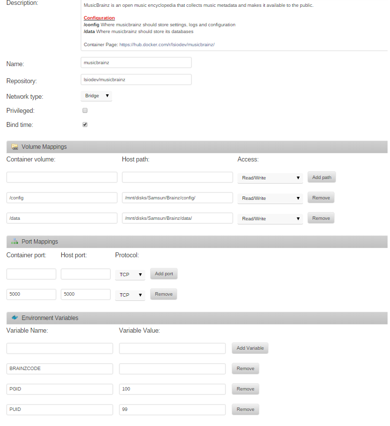

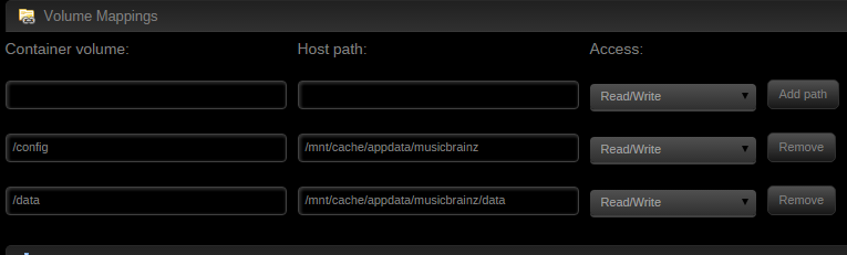

can you screenshot your folder mappings.
Attached. It looked like it stalled during downloading the docker, so i may just need to redownload it.
Edit: I delete the config folder and started the container again. So far its importing as expected.

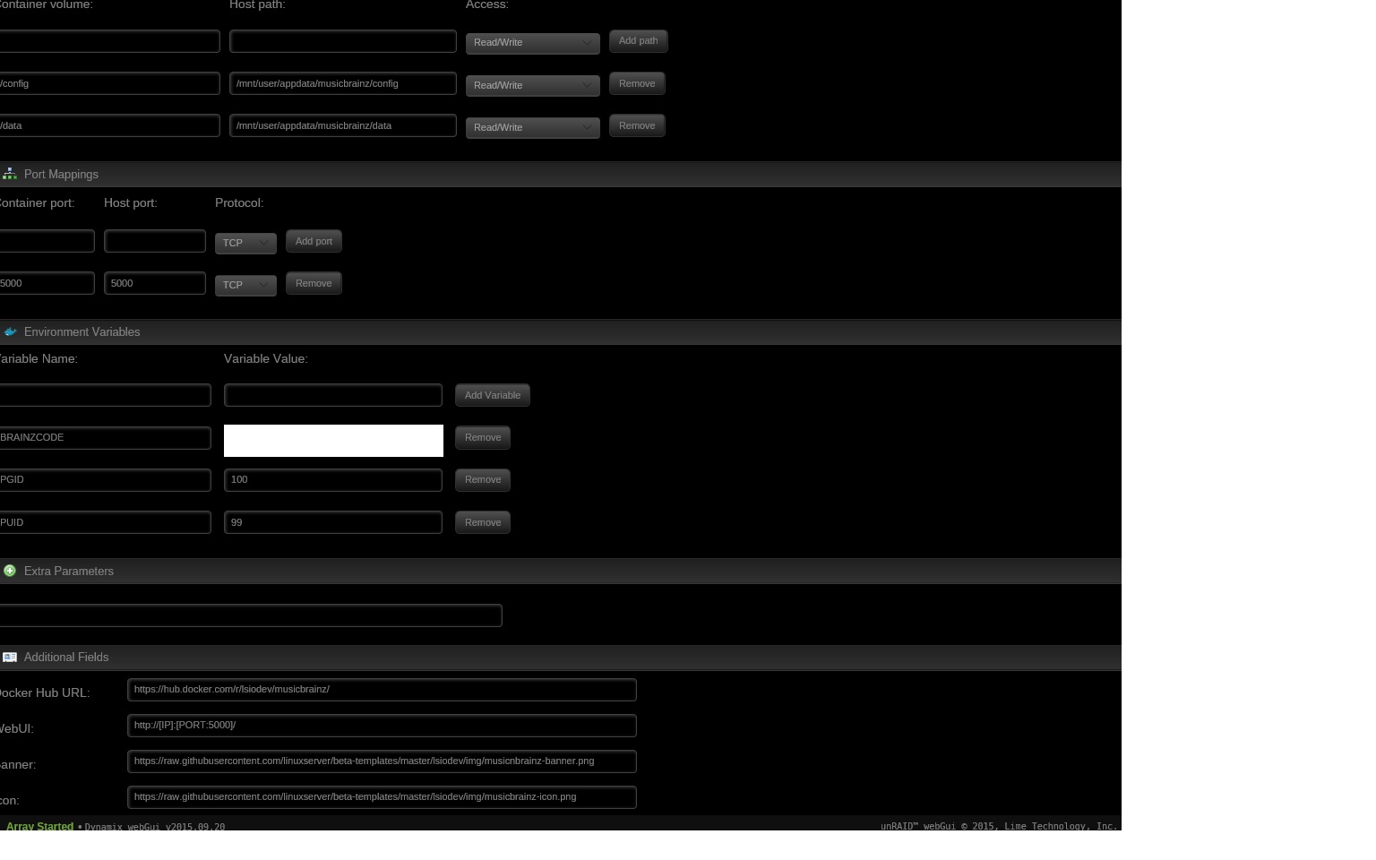

Attached are my mappings etc as requested from the other thread.
This drive is mounted with unassigned devices and works for the other dockers I have, it was just this one docker that fails after grabbing.
even tried mapping the files to the cache drive with the below log messages. Refresh the dashboard page and the docker is shown as off.

I just tried installing the docker but it keeps getting to the same spot and failing, and by failing I mean when the page is refreshed it shows the docker as stopped.
_ _ _
| |___| (_) ___
| / __| | |/ _ \
| \__ \ | | (_) |
|_|___/ |_|\___/
|_|
Brought to you by linuxserver.io
GID/UID
User uid: 99
User gid: 100
We are now refreshing packages from apt repositorys, this *may* take a while
(Reading database ... 27044 files and directories currently installed.)
Preparing to unpack .../git-core_1%3a1.9.1-1ubuntu0.2_all.deb ...
Unpacking git-core (1:1.9.1-1ubuntu0.2) over (1:1.9.1-1ubuntu0.1) ...
Setting up git-core (1:1.9.1-1ubuntu0.2) ...
initialising empty databases
screenshot of the container settings attached.

I'm still having issues getting this going. I have tried:
  • Nested and non-nested folders
  • Cache, external, array drive
  • Deleted/Recreated Docker
  • Deleted/Recreated folders
  • Created new MetaBrainz key
root@Tower:/mnt/cache/appdata# docker logs musicbrainz
*** Running /etc/my_init.d/005_set_time.sh...
Current default time zone: 'America/New_York'
Local time is now:      Wed Dec 30 12:16:41 EST 2015.
