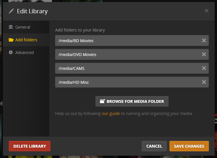

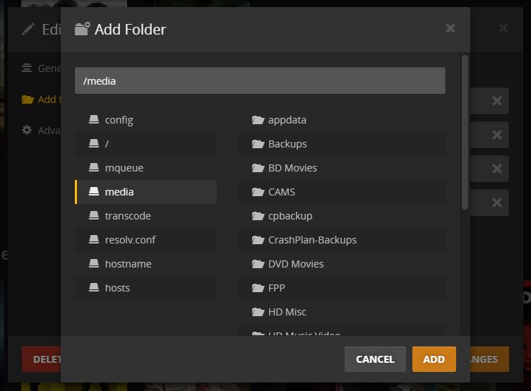

screen shot of mine attached

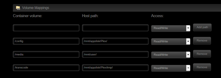

here is my docker mappings and what I see when I go to add a folder in plex
Myk
Myk
