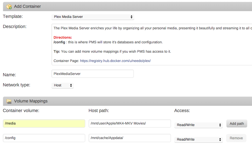

Do you have Community Applications installed? After choosing a plex docker, but before you actually push the button to add it, post a screenshot showing how you have configured it including the Volume Mappings, and we can take a look to see if you are on the right track.

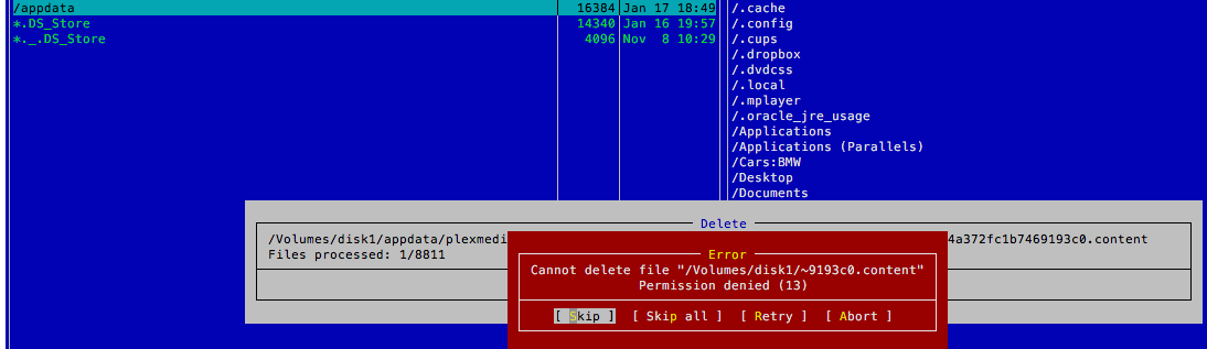

I've tried unsuccessfully to remove the Appdata share that initially was added to my Disk1 apparently as a share by the system and/or Docker (probably 1st Plex attempt).  It has somewhat over 3300 files and when attempted to delete yields an error code - 8072.
In order to even attempt the delete, I had to remove User Shares from the Global Setting and keep Disk Shares in order to even make that attempt.

The simplest thing I can recommend without a lot of discussion about your specifics is to google Midnight Commander and telnet. Midnight Commander is easy to use and will let you take complete control of your files. Your disks and shares are in /mnt.
Hi Trurl,

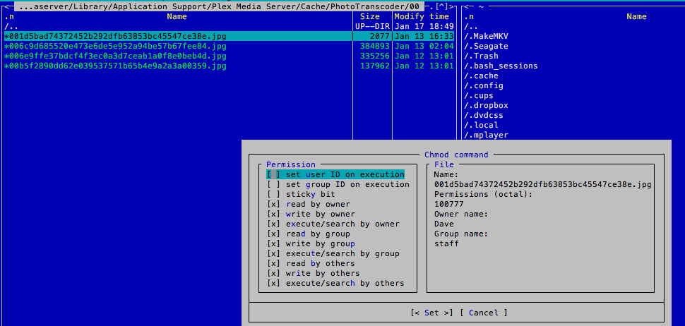

Thanks for the tip.  I've gotten MC installed and attempted w/some success to delete the Appdata directory, but some files refuse deletion and despite reading and checking chMod commands, can't seem to change the status of the 1000's for .jpg etc. type files in order to totally delete all the sub-directories (???) and files.
Commands appreciated  :-\
MC is already installed, no need to install it. Telnet or SSH into your server, type mc and away you go. From your screenshots it appears you are trying to do this from a network client instead of on your server.
Thanks Jonathanm.  From Trurl's original post, I thought I had to download & install MC directly to my Mac.  I will try your method to Telnet into my Tower Server & report back.
Dave
Thank You Thank You Thank You - SUCCESS  :D

I think I have everything you suggested short of creating the Plex Server as in your previous post.
Community Applications, Appdata in Cache only, see attached Plex with my proposed mapping (see attached).
Thanks to all for your extraordinary help & assistance, much appreciated!
Dave
You have a User Share named Apple with a subfolder named MK4-MKV Movies. Is that the only media folder you want to use with Plex?
