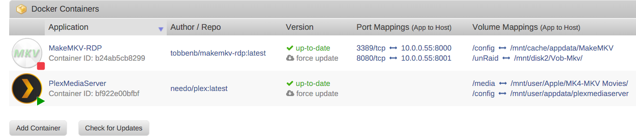

Just so I don't create another big mess in my system.  Could you post a copy of your Volume Mapping.  I'm pointing /config to my /mnt/cache/ (though wonder if each "docker" should have a named /config for future clarity).  The other ? is should the /unRaid/ be pointed to a disk(1-3) or an /mnt/user/(specified folder).  Do I need to worry about Ports???

if you made the appdisk share it would be
/config > /mnt/cache/appdisk/plexmediaserver
/media > /mnt/user
each docker will start with /mnt/cache/appdisk/<docker config dir per docker>

Thanks for the response.  I did create the "Appdata" share on Cache (pool) for my Plex Server et. al.  Does the /config file for each docker go to the "appdata" folder?  It would seem that might create possible over-wrights?
Dave
Each docker needs its own folder in appdata.  So you would want to map the Plex docker's /config folder to /mnt/cache/appdata/plexmediaserver
Much Obliged!  That makes much more sense to avoid conflicts.  Does the Port Specification (required per makemkv-rdp docker) make a difference?  Also can a new folder be created (not previously in existence - ie Vob-Mkv) on a disk and/or share via the Volume Mapping?
Dave
Yes, they need to be unique, can't use the same host port for two different dockers... UNLESS you don't run them concurrently
Yes

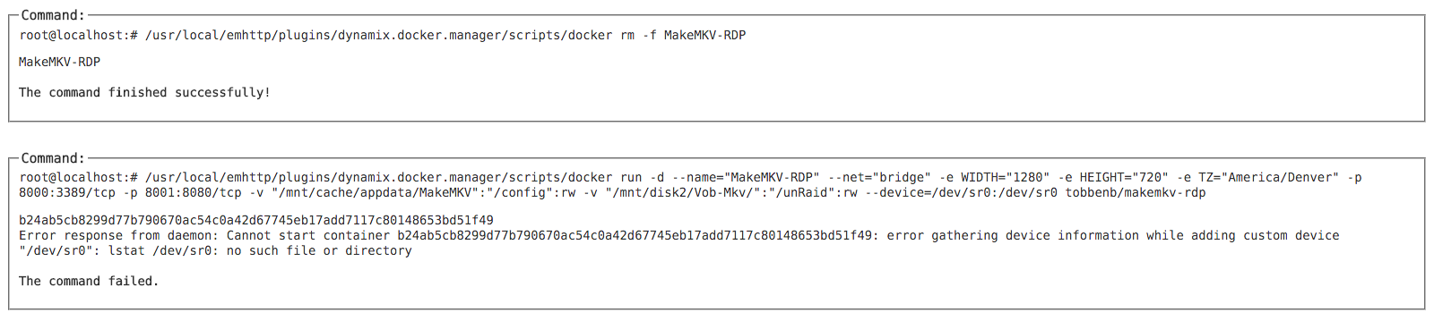

Slowly but surely, I'm beginning to get the "hang"  :P of this stuff.  However, when I created the MakeMKV-rdp docker I get the following error and a "red" box (probably means not working).
Dave
Hi Guys,
Still haven't got makemkv-rdp docker to work and am not sure why it failed (see pics previous post).
Also for the cogni cieri ;) why is my Plex Server only reachable by 10.0.0.55:32400/web/index.html#.  If I use the direct Plex - app.plex.tv/web/app# I'm only able to see my Son's Plex Server.  My guess is it's something in my network, but am not sure how to adjust either the Docker or the Network to make it available to my devices.  Locally they are all on the same network.
Thanks
Its failing because you don't have a device the extra parameter of "--device=/dev/sr0:/dev/sr0" is looking for.  Try removing that from extra parameters (adv mode on) and try starting it.  You will then have to open files from the file menu to find your movies to convert instead of a dvd/br drive.
Myk
Myk
MYK - ta da :)Exactly Right!  Thanks so much for your help and analysis!  Now to fix the Plex problem.
