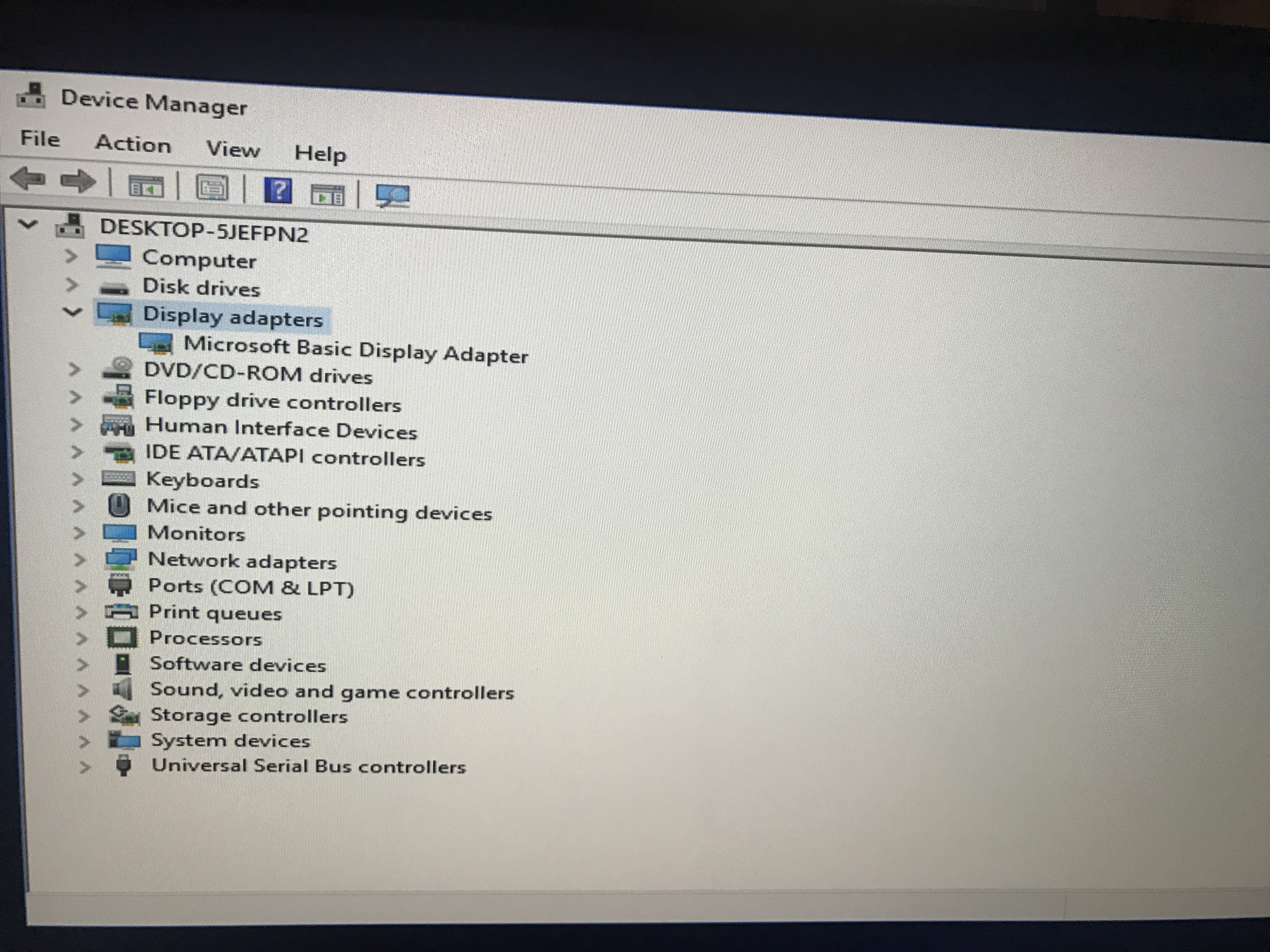

GPU drivers failing in windows 10 VM (Code 43)
I recently installed unraid and a windows 10 VM. All was going fine. Stable good, performance.
Then shortly after adding a new HDD to my array my GPU driver just stopped working with the following error:
Windows has stopped this device because it has reported problems. (Code 43)
What I've tried:
- Removed all GPU drivers from the VM and reinstalled the latest from Nvidias website
- Uninstalled the GPU from device manager and reinstalled
- Created a fresh VM, still the same error. This makes we think I've messed up something in unRAID or my GPU is dead
- Just tried a spare GPU and got the same results. (So I've tried a GTX970 and a GTX750ti)
- Maybe its a plugin I've installed. I'll try disabling these.
XML:

Anyone got any ideas?

Post the xml of the vm and the diagnostics zip file from Tools --> diagnostics.
Just attached them now.
You need to disable the hyperv extensions, else Nvidia drivers detects it's a VM and returns error 43.
Make sure you have the following section bellow and will be solved.

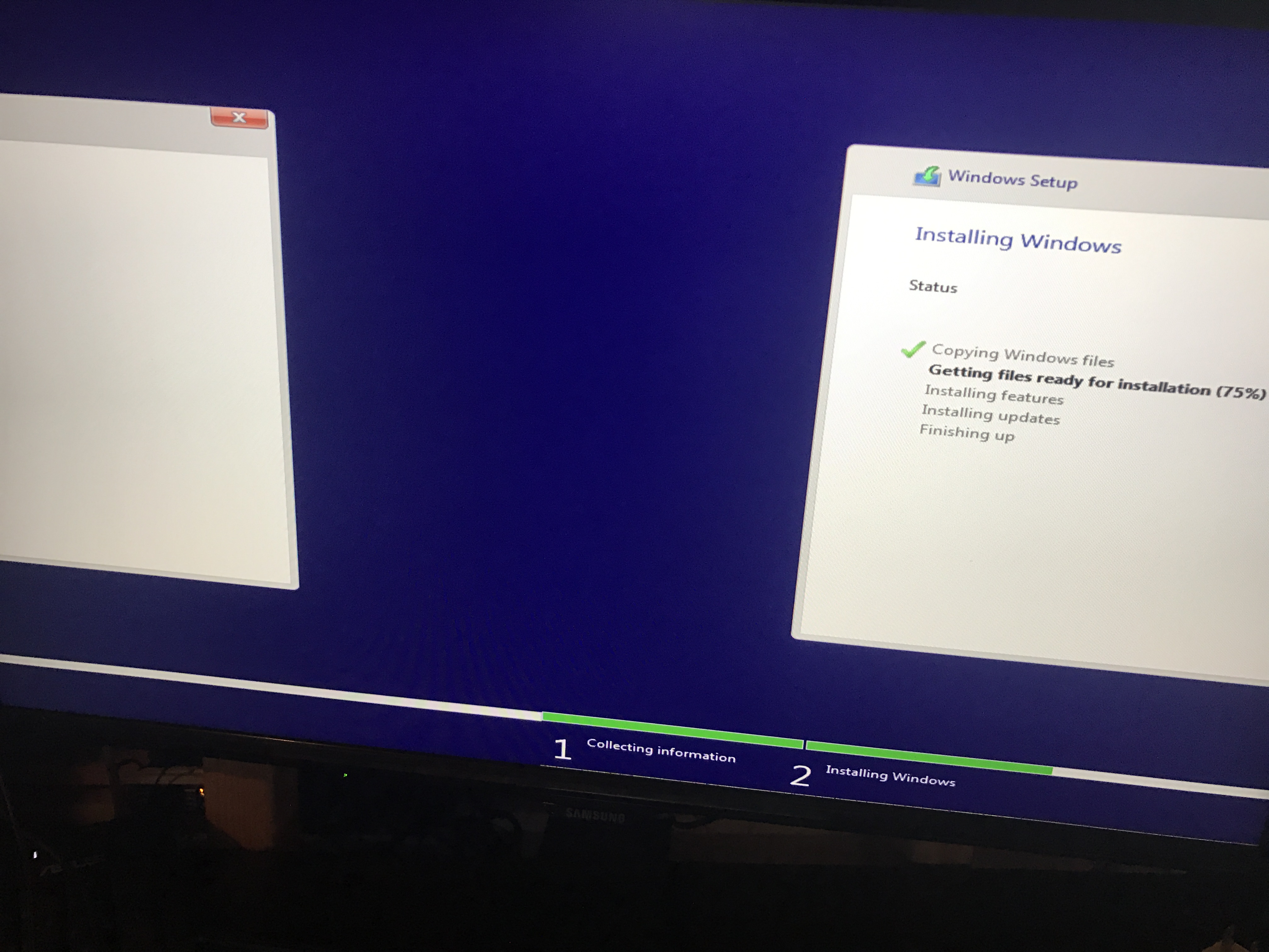

Wicked I'll switch that over. Thanks a bunch man. Waiting for windows 10 to download ATM as I had the wrong language for the key I have -_-
YUP! all working :)

This topic is marked as solved, but I just read through the posts and it doesn't seem like it has been resolved. I am currently having the same issues.
The virtual machine can output video from my GTX 1080, but the resolution is insanely low and Windows says:
Here is my setup:
  • Unraid Version: 6.3.5
  • 10 HDDs - 4 are connected through a pcie expansion card, the other 6 are connected directly to the motherboard
  • Updated motherboard bios to most recent version
  • Bios has vt-x enabled obviously for the vm to run
  • Main GPU slot has a low end graphics card that the Unraid OS can use for output.
  • EVGA GTX 1080 is in PCIE slot 3 - IOMMU group 26 all by its self:
    • [10de:1b80] 03:00.0 VGA compatible controller: NVIDIA Corporation GP104 [GeForce GTX 1080] (rev a1)
    • [10de:10f0] 03:00.1 Audio device: NVIDIA Corporation GP104 High Definition Audio Controller (rev a1)
I had to put this line into my syslinux.cfg file to be able to boot the VM with the graphics card in passthrough mode:
  •  append vfio_iommu_type1.allow_unsafe_interrupts=1 initrd=/bzroot
Onto the VM setups that I have tried:
  • Windows 10 VM:
    • Bios: OVMF
    • Machine: tried Q35-2.7 & i440fx-2.7
    • Hyper-V: NO
    • VirtIO: virtio-win-0.1.126.iso
  • Windows 7 VM:
    • Bios: Seabios
    • Hyper-V: NO
I uninstalled as many plugins as I could without crippling my home server. This is what is remaining as far as plugins:
  • CA Appdata Backup/Restore
  • CA Appdata Cleanup
  • CA Fix Common Problems
  • Community Applications
  • CrashPlan
  • CUPS
  • Dynamix Cache Dirs
  • Dynamix Schedules
  • Dynamix SSD Trim
  • Dynamix System Buttons
  • Dynamix System Temp
  • Plex
  • Transmission
  • Unassigned Devices
  • Zoneminder
I spent close to 6 hours working on this yesterday.   I have also made an attempt or two at passing a vbios by manually modifying the XML, this did not seem to make a difference. As I was grinding on this yesterday, I did see an admin that claimed to have a 1080 working in passthrough. I can't remember who, maybe Jon? I would really appreciate some insight here.
Windows 7 VM XML.txt
Windows 10 VM XML.txt

Ok I'm installing. this is what I'm looking at. Haha.
Just a note. It seems as though windows 10 installer would lock up at the windows 10 logo when using OVMF. Switching to seabios, I was in the installer with 10 seconds.
Edited by JimJamUrUnraid
Ok it booted up. First thing I did was check device manager. Showing up as "Microsoft Basic Display Adapter"
i have ave followed up through step 5. Are there certain steps I should follow now?
Ok I have had no luck even with never having the vm set to vnc, That didn't make much of a difference from what I can tell. After loading the proper nvidia drivers I was still met with the horrid code 43 error.
You could also try to add the vbios again. @gridrunner has a collection of vbioses that you might you if it's the same memory size on your card.
Just having a quick look through your xml i see you are adding the rom file to the sound part of the gpu xml
