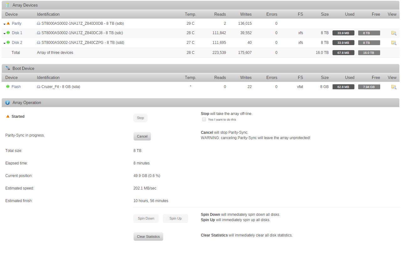

Started over, set my parity disk and disk1, disk2.  It formatted disk1 this time.  However, there appears to be a mis-match on the total size reported.  Not sure if that is a bug or just because it has not completed the parity check.  Total under Array Devices is correct (16.0TB) but "Total size" under Array Operation is not, 8 TB.  Image attached...
Thanks for any info.
8TB is referring to 8TB of Parity not total array size. ;)
Thanks Kizer.... it's not readily clear to a new user...
but makes sense now that all the other info being show is about the Parity-Sync.
