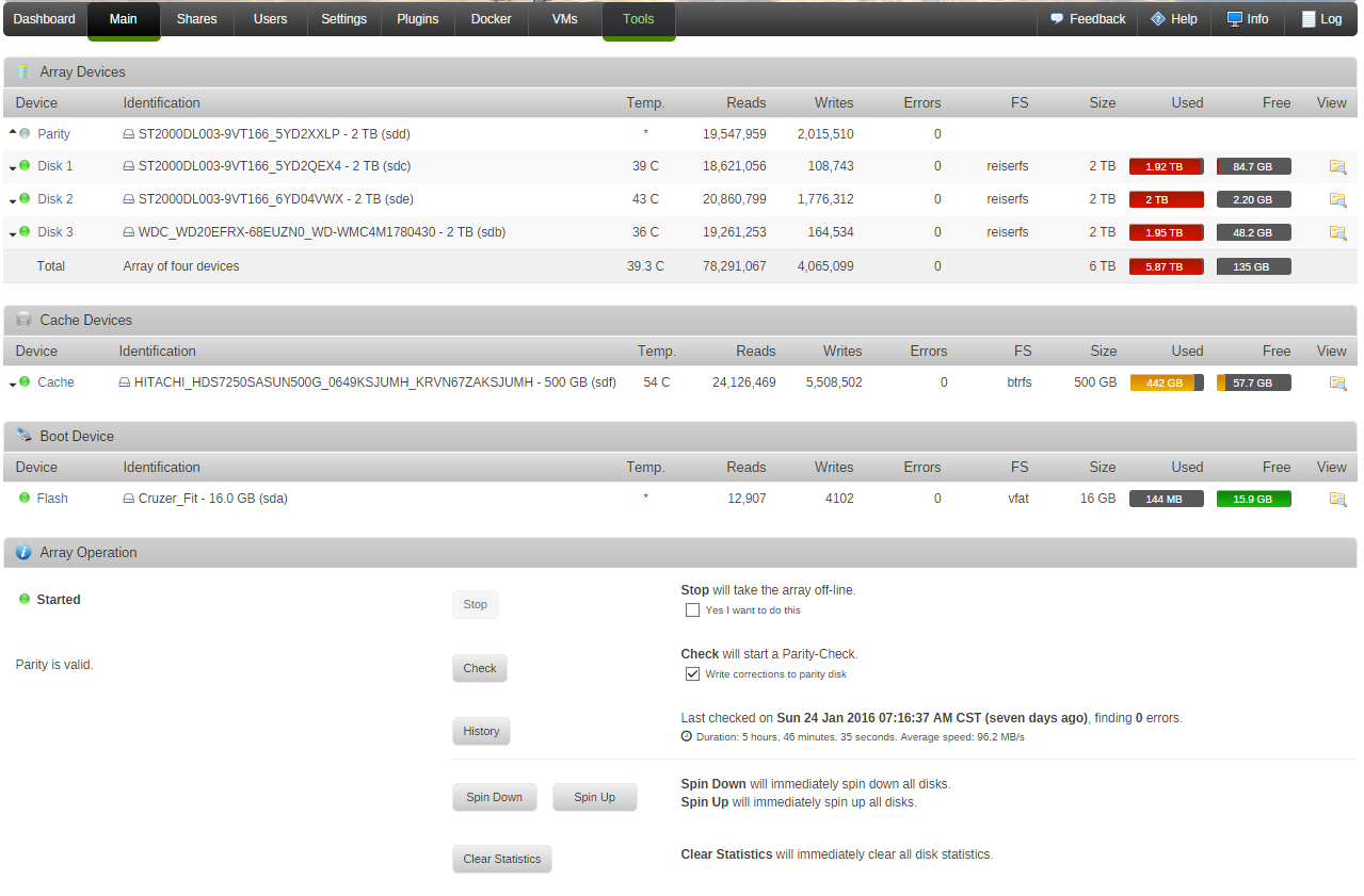

Disk2 keeps on running out of space when other drives are spaceous (high water)
First, my setup:
Cache drive- 500 GB
Parity- 2 TB
Disk 1,2 and 3- all 2 TB
I have a media share, named Media.  I'm using High-water allocation method.  Minimum free space is 2 GB.  My split level is set to top three directory levels as required.  Use Cache disk setting set to yes.
My folder structure is
Media  /TV        /Show Name  / Season #
Media  /Movies  /HDMovies    /Movie Name
My setup should be TV and Movies are found on all drives.  Show name and HDMovies can be found on all drives.  But each TV season should be in 1 drive alone, so goes for Movie Name.
What happens is all downloads are left in the cache folder when disk2 is full.  When disk2 is free, shows started moving to disk2, while disk1 and disk3 are quite free.  Please see screenshot.

Hopefully you understand that your basic issue here is you don't have minimum free space set to a high enough value (or at all), so the system is attempting to write to disk 2 and not succeeding.
HOWEVER ... looking at your GUI display, you have a more fundamental problem:  ALL of your disks are effectively full !!    Buy yourself a couple of 4TB (or larger) drives and upgrade your parity to the new size; then replace one of your data drives !!

As was noted earlier all your disks seem to be pretty full so you are going to start running into problems whatever is happening now.
Yup,  you are right. I am really out of space. I don't know where all that space went [emoji1] trying to delete plenty of files now. But somehow,  Ivm downloading more than I'm deleting.
wow jang430  looking at the screenshot of your gui your cache drive is hot at 54c
So far,  it's been like that since more than half a year.
If it's been consistently running at that temp, you either need to replace the drive or improve the ventilation for it.  Is there a fan that provides ventilation for that drive?
Note that the temperature spec for that drive is 55° C => so it's running right at its upper threshold.    This is a bad sign ... it generally means the drive is going to fail sooner rather than later.    But it may just be that it's mounted without adequate ventilation ... so check for that first.
... An easy fix to the cache drive temp issue (assuming it's not simply poor ventilation) is to repurpose one of your 2TB drives as the cache after you get a couple 4TB (or larger) drives ==> this would fix both the space issue and the too-hot drive issue  :)
So far,  no fan in there. Will fix that first.  Thanks for the advise.
