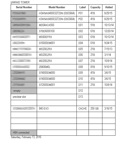

In have 3x 5in3 drive cages. I can't see the drives inside them so labels on the drives themselves won't work. So I labeled the front panel of the caddies P01, P02 (I have 2 parity drives) D01, D02, etc. Then I made a nice Word doc table layout to record drive model, serial number, date put in service, slot number. I also did some cell shading to indicate those drives connected to the RAID card vs the motherboard. I store a printed copy in a manila envelope taped to the side of the case. With all this I know who is connected to what and for how long.
