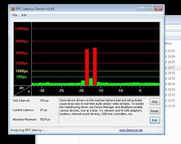

If I use something like dpclat, it shows almost continual green with very very low latency but occasionally it'll just spike red. I put my TV tuner in and passed it through to the VM (had to use PCI-E override to do this though). While it works fine, the dpclat app then shows it alternating between green and yellow almost continually the whole time I have a TV channel tuned (only seems to affect HD broadcasts for some reason, I'm assuming due to the larger data rate?).
It seems also worth noting that using a Windows 10 VM doesn't seem to have any issues with the same config XML as a Windows 7 desktop.

With this setup, I had audio "crackling" listening to youtube. I used the dpc latency tool, and it was all red. It seemed like the more CPUs, the higher the latecy. I started out with 3 cpus. (2 hyperthread-paired, plus one more.) Dropping down to one hyperthread pair helped, and dropping down to one VCPU helped the most.  (All yellow, some green.) Audio "crackling" through my USB headset was also better, but still slightly noticable.
Passing through the USB controller solved almost all the audio problems. Boot time was also noticeably faster on my SSD, without the spinner pausing. (10 seconds to boot instead of 30.) DPC latency started as green/yellow, with spikes up to red.

Launching a VM that runs on other cores caused intermittent red. This made me think that KVM emulation was stealing CPU cycles, so I isolated the CPUs. isolcpus=1,2,3,5,6,7 made it much worse -- ~8000 microseconds. Pairing CPUs didn't help. I wonder if only leaving 2 cores for unraid causes the usb device sharing to have a harder time?
After reverting isolcpus, I noticed that if I play an mpg, the latency drops to under 1000 microseconds. If I stop it, latency spikes up to 4000 microseconds. Maybe that's the performance management of the CPU from the host? I didn't tweak anything with the "Tips and Tweaks" plugin -- so my scaling governor wasn't set for "performance". I've since changed that, but I haven't re-verified this behavior.
I've also pushed my luck and installed a 2nd GPU, replacing my Supermicro MV8 controller with a cheapo PCI Express 2.0 x1 one. My DPC delays are back into all-red territory, so I have some more experimentation to do. I'm suspicious of the high qemu host CPU usage when the VM is idle. Basically this is eating up 2 cores. I've seen some things online that indicate that Windows interrupt processing could be causing problems, which would coincide with the crackling audio and high DPC delays that I'm seeing again with this setup. For folks with more cores than me, pushing the KVM workload to isolated cores might be working for you, but I don't have enough cores to do that. :(
