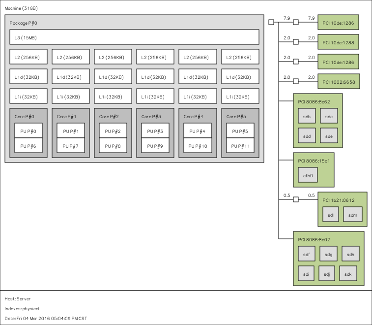

I was doing some Googling on the issue of KVM Latency and a number of places recommend HT off. Its only a marginal boost HT, so I can live without that
I also see elsewhere JonP is saying next unRAID will have ISOLCPUs toggle in webUI - as that is supposed to help
https://lime-technology.com/forum/index.php?topic=43126.msg418893#msg418893
So maybe a combination of those and the script?

Now the siblings value = the cpu id value, so I didn't get the expected output as what was explained above.
However the core_id value shows that 0-1, 2-3, 4-5 .... are the correct pairings.

Well I'm starting to find this interesting, primarily from an efficiency point of view!
A couple of things, the
<emulatorpin cpuset= >
seems to be widely used to reduce latency.
Maybe something that is worth trying within your XML.
lstopo or also known as hwloc-ls displays the hierarchical topology map of the current system.
Getting this to run in Slackware would give the output we want to see.
hwloc-ls is available for Slackware https://www.open-mpi.org/projects/hwloc/
Lots of good info below, if someone has enough time to kill (I do not right now) you should follow the steps in the 2nd link.
Primer: https://a20.net/bert/tag/libvirt/
Guide: http://docs.openstack.org/developer/nova/testing/libvirt-numa.html
My output from hwloc - I'm still none the wiser. Does this tell me that 0,10 - 1,11 etc are paired?

I think that is what it means.
10+ packages later, and I have the lstopo graphic output (I had no idea it would take that many packages to make a png of my system!).
Either way, pretty cool, but is the opposite of what virsh capabilities output displayed.
Attached

root@Tower:~# cat /sys/devices/system/cpu/*/topology/thread_siblings_list | sort -u
0,8
1,9
2,10
3,11
4,12
5,13
6,14
7,15
root@Tower:~#
We now have LOTS of ways to do this!..  ;D
You can also do this (credit to Samuel Holland on VFIOl):
grep . /sys/bus/cpu/devices/*/topology/core_id
Results:
/sys/bus/cpu/devices/cpu0/topology/core_id:0
/sys/bus/cpu/devices/cpu1/topology/core_id:1
/sys/bus/cpu/devices/cpu10/topology/core_id:4
/sys/bus/cpu/devices/cpu11/topology/core_id:5
/sys/bus/cpu/devices/cpu2/topology/core_id:2
/sys/bus/cpu/devices/cpu3/topology/core_id:3
/sys/bus/cpu/devices/cpu4/topology/core_id:4
/sys/bus/cpu/devices/cpu5/topology/core_id:5
/sys/bus/cpu/devices/cpu6/topology/core_id:0
/sys/bus/cpu/devices/cpu7/topology/core_id:1
/sys/bus/cpu/devices/cpu8/topology/core_id:2
/sys/bus/cpu/devices/cpu9/topology/core_id:3
or this:
grep . /sys/bus/cpu/devices/*/topology/thread_siblings_list
Results:
/sys/bus/cpu/devices/cpu0/topology/thread_siblings_list:0,6
/sys/bus/cpu/devices/cpu1/topology/thread_siblings_list:1,7
/sys/bus/cpu/devices/cpu10/topology/thread_siblings_list:4,10
/sys/bus/cpu/devices/cpu11/topology/thread_siblings_list:5,11
/sys/bus/cpu/devices/cpu2/topology/thread_siblings_list:2,8
/sys/bus/cpu/devices/cpu3/topology/thread_siblings_list:3,9
/sys/bus/cpu/devices/cpu4/topology/thread_siblings_list:4,10
/sys/bus/cpu/devices/cpu5/topology/thread_siblings_list:5,11
/sys/bus/cpu/devices/cpu6/topology/thread_siblings_list:0,6
/sys/bus/cpu/devices/cpu7/topology/thread_siblings_list:1,7
/sys/bus/cpu/devices/cpu8/topology/thread_siblings_list:2,8
/sys/bus/cpu/devices/cpu9/topology/thread_siblings_list:3,9
Both of these, plus the one mentioned a couple posts up, and lstopo are in agreement..
I consider this question now well covered to discover what the layout is.
