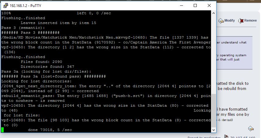

Just an update after i have format disk3 to xfs data rebuild ,since this was a mistake i have formatted back to reiserfs and runned(at the moment is at pass3 and i see that starts to recover my files one by one.finger crossed i will inform about result and how to proceed :) )  reiserfsck --rebuild-tree -S /dev/md3
