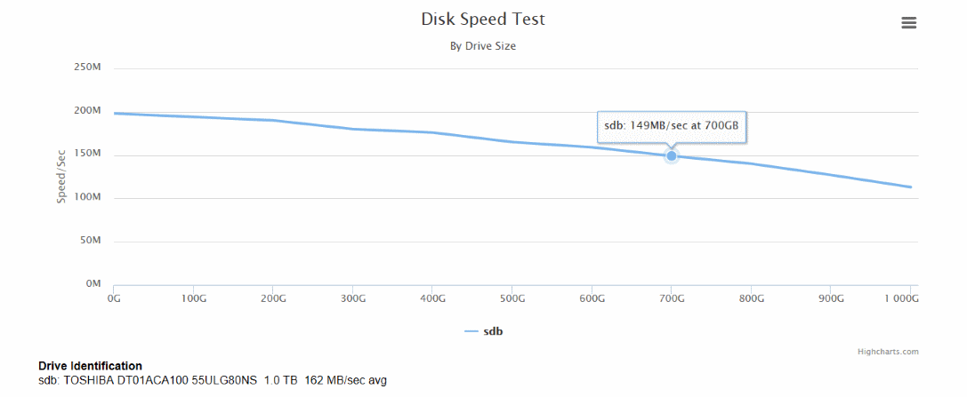

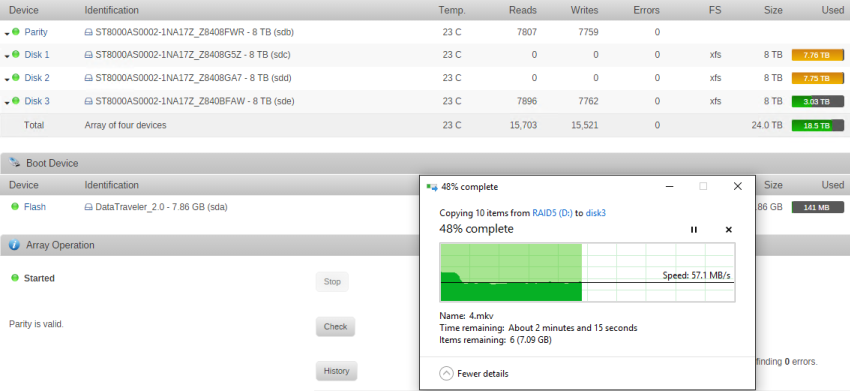

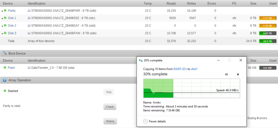

Diskspeed graph below, 75MB/s at 70% makes sense, half its speed, but the same speed or a little more in the beginning makes me believe I’m hitting some limitation, don’t have a clue what it is.
Parity check with these disks closely follows the graph.

Yeah that graph definitely rules out my potential explanation for what you're seeing.  Interesting.
Your numbers using SSDs would seem to disprove any theory that it's the operating system, or motherboard, or disk controllers.  That leads me to start thinking along the lines of it having something to do with rotational latency.  But I'm way out of my areas of expertise on this, it's just the only thing I can think of so far that might prevent effective write speeds from scaling with increased drive *sequential* throughput.  With SSDs not suffering from rotational latency, they would exhibit effective write speeds much more reflective of their sequential throughput.  Again just reaching for *something* in the way of an explanation for what you're seeing, I could easily be way off.

I did some tests on my server with 8TB Seagates, did two copys:
to disk3 (38% full): ~60MB/s (disk speed at this position ~175MB/s)
to disk1 (97% full): ~50MB/s (disk speed at this position ~100MB/s)
Based on these and the Toshiba results I’m thinking that rotational latency does limit max write speed in Unraid and 5400/5900rpm disks max out at ~60MB/s and 7200rpm disks at ~80MB/s.

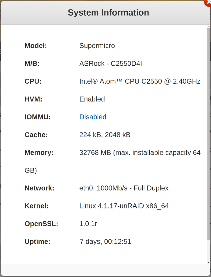

Back to the build: I hit a solid week of uptime with zero issues.  I'll be adding a 3-bay hot swap drive cage next; I anticipate about a 3-watt hit for that.

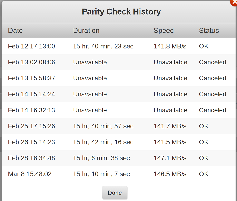

Parity Check finished in 16 hours 10 minutes, within 3.5 minutes of the previous run.  I had increased the poll_spindown frequency from 1/1800 to 1/60, so that might be related.

That’s a good average speed but with some tuning you could probably shave an hour, these are from an HP N54L with 4 x 8TBs, before and after tuning:
16h46m13s – 132.5MB/s
15h01m14s – 148MB/s
15h01m14s – 148MB/s
Nice improvement for sure.
I actually typo'd that last post, my times are all in the 15-hour range . . . you can see my before-and-after-tuning improvement, where I pick up around half an hour (~142MB/s -> ~147MB/s)
OK, that’s very close to optimal for these disks, in that case you’re good.
