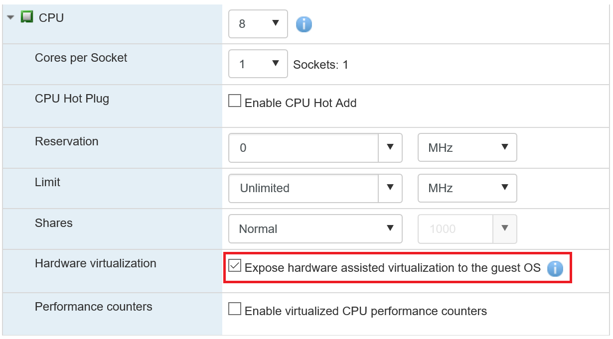

July 29, 201610 yr Author Hyper-V doesen't detect that it is running inside a VM anymore but it still doesn't detect that virtualization is enabled. We have to find something like this in VMware for QEMU/KVM I think that your post is on VMware Workstation, on my ESXi 6.0U2 that you can open it like this
July 30, 201610 yr Hyper-V doesen't detect that it is running inside a VM anymore but it still doesn't detect that virtualization is enabled. We have to find something like this in VMware for QEMU/KVM I think that your post is on VMware Workstation, on my ESXi 6.0U2 that you can open it like this I think they should be the same settings (not 100% sure through). In the config file you can add vhv.enable = “TRUE” hypervisor.cpuid.v0 = “FALSE” as well Source: http://www.derekseaman.com/2014/06/nesting-hyper-v-2012-r2-esxi-5-5.html
