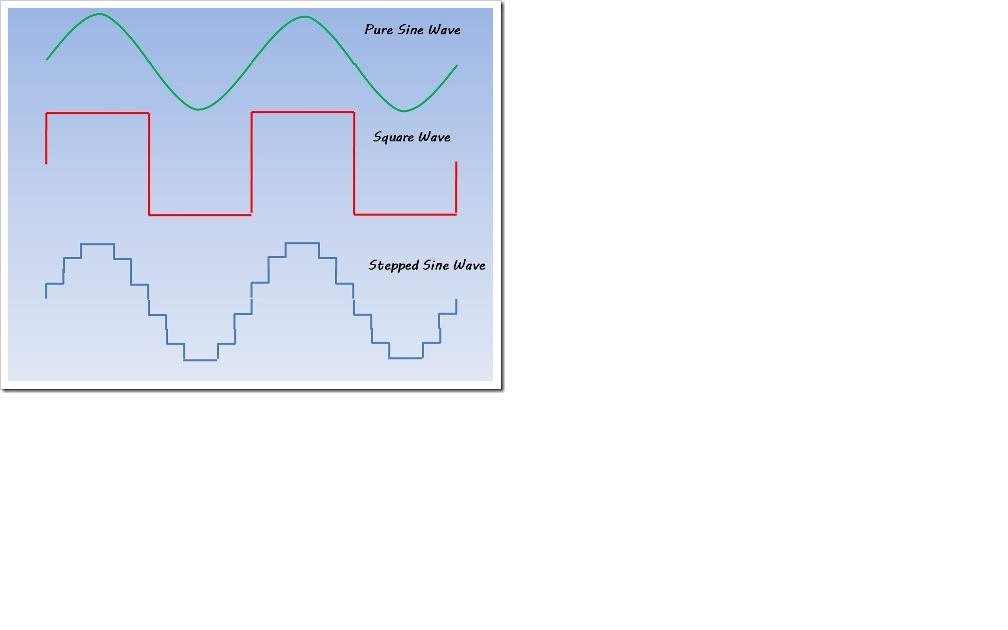

The less expensive units has a stepped output wave voltage output that 'approximates' a sine wave.  The pure sine wave is what your power company is supposedly delivering to you and has a a single sine component of 60Hz.  The step-output voltage waveform has a major component at 60Hz and any number of smaller harmonic components that are multiples of 60HZ.  These higher frequency components can cause some power supplies to run hot and become less efficient.  (That is why I made the comment about running time on the UPS.)

If you had an oscilliscope and looked at the waveform going to your computer, it would normally be a sine wave, like the first picture shown below.  A "pure sine wave" UPS will produce an essentially identical waveform.    Lower quality UPS units use square wave generators, which can be added together to produce a approximation of a sine wave usually called a "stepped sine wave" => the other picture below show a pure square wave, and a stepped sine wave.
Note that ever "edge" (the corners of the square waves) generate harmonic noise on the electrical line => and without going into the technical details, just note that noise = BAD  :)
As I already noted, the unit you bought is excellent.
