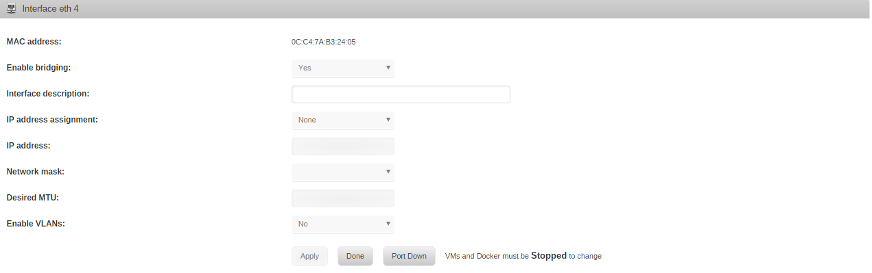

With v6.2 you can bridge all NICs, so eth1 becomes br1, just FYI in case it doesn't work with eth1.
@johnnie.black
That is good to know.
Do you have to do anything special to get br1 active?
@Flick
I would recommend trying br1 instead of eth1.
Network Settings -> Enable bridging -> Yes
E.g., eth4 is for my secondary ISP, have one VM that uses br4
