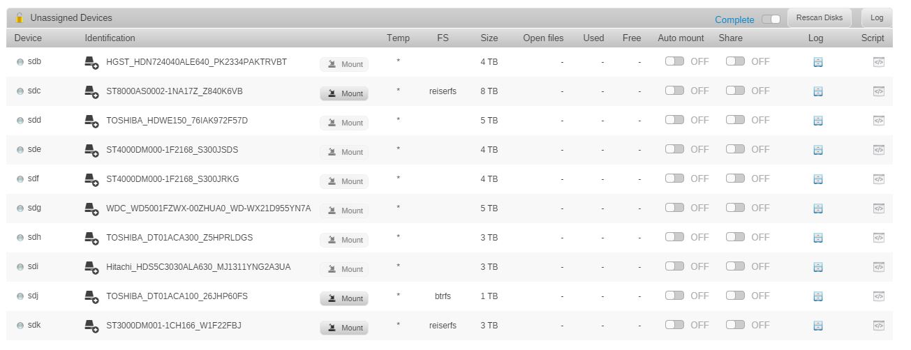

I have been converting my drives to XFS and copying data from reiserFS drives like I see explained in the sticky.
When I went rebuild a new array, I accidentally added one reiserFS drive to the array.  Unraid told me it all of the XFS drives have no FS and I need to reformat them.  I said no and canceled of course.  I realize now that I should have left the reiferFS drive out of the array or just did one more conversion first.
Now my unassigned devices look like the attached.  I did not reformat them, but unraid does not recognize the XFS disks.
Please tell me there is some way to restore XFS and all of the files on these disks.
Thanks.
FYI -- I also posted this in the XFS conversion thread, not sure where it belongs.  I am happy to remove one of these posts. But the issue started here.
