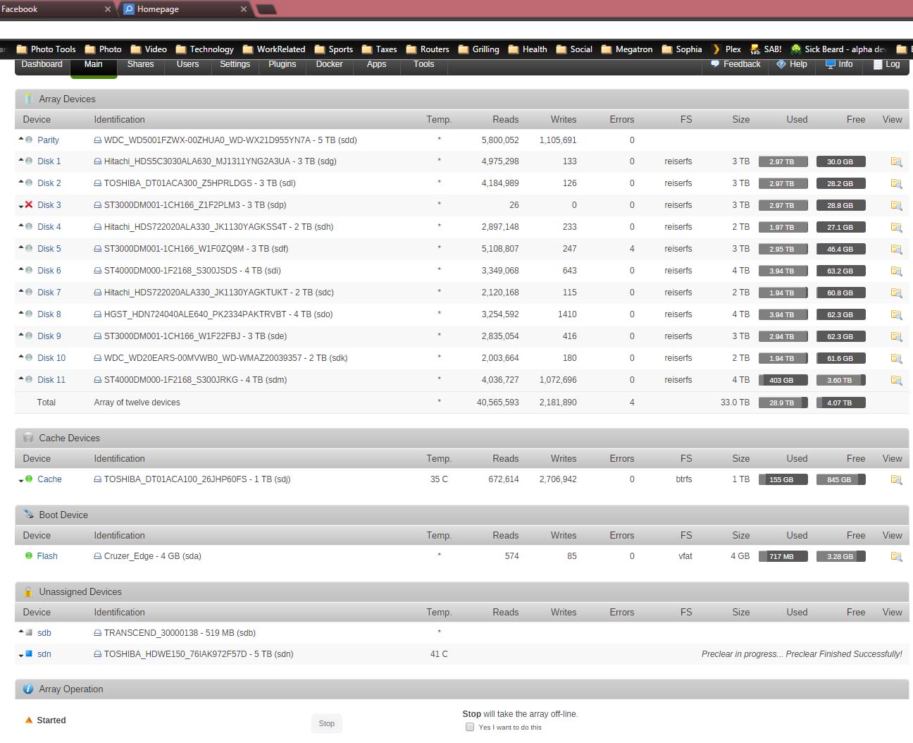

What disk is this?
TOSHIBA_HDWE150_76IAK972F57D (sdl)

Which slot was redball and which was the "unbootable"?
Redball was for several weeks.  Maybe a month.

What disk is this?
HDWE150_76IAK972F57D is the 5TB disk I bought to replace the original redball.
disk 3 - Z1F2PLM3 was the original redball... see the attached capture.
disk 5 - W1F0ZQ9M is the disk i cannot boot with now.
The one thing I did not do was confirm which disks were in each slot in the chassis before I started mucking around.  So now I am unsure if there may have been a problem with the disk 3 slot, that has affected disk 5 now.  Either way, I have a new 3TB disk on the way that I will use to attempt to clone W1F0ZQ9M.
