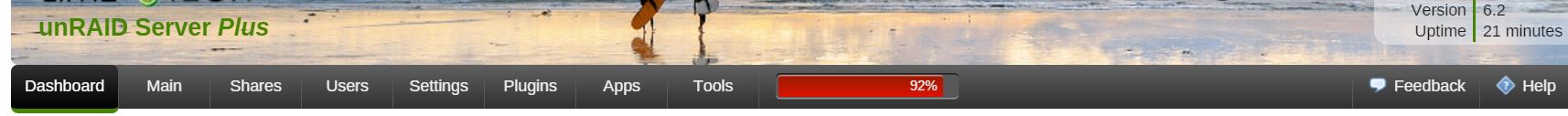

Btw, anyone have any ideas on why my Docker tab disappeared? And I take it back, none of my docker apps are running:
I had same issue, deleted dynamix.plg, restarted, was able to get to WebUI. Updated raid to v 6.2 from 6.1.9. Also updated Dynamix.
But now I don't have the Docker tab and not sure how to make it show up again. Apps seem to be running though, Plex works and I can go to config pages of apps via their specific ports. Just no Docker in sight..
@RobJ, just out of curiosity, what's the downside of running a parity check beyond it taking a while and eating into HDD life?
Just the time lost (and the extra heat generated, and the power used, and the impact on other things you may try to run).
I'm not the Docker expert, but you may want to visit the Additional Upgrade Advice page (is docker.img on an unassigned drive?) and the Docker FAQ.
