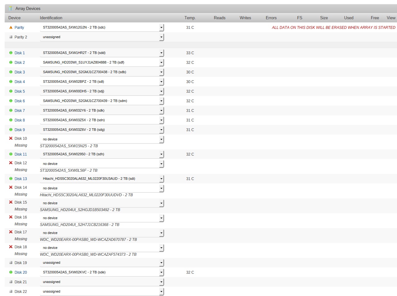

I've not really touched my server since I installed it several years ago, it's worked flawlessly aside from 2 failed HDDs at different times, and parity rebuilt fine.  My array is 34.5TB made up of 20 x 2TB hard drives, and now that I'm about to start migrating over to 6TB drives, I thought I should upgrade the O/S.  I was on unraid 4.7, and I followed the upgrade instructions.
Everything went fine, and I copied my Pro key and the .cfg files (disk.cfg, ident.cfg, network.cfg, share.cfg) as well as my shares folder, into the new config folder.
The server rebooted fine, but none of the drives were assigned.  I went through and re-assigned them to the original order, and it came up with a warning that the parity drive would be erased when the array is started, and that parity needed to be rebuilt.  I clicked to start the array before realising I should have just clicked "parity is valid"...but too late.
Anyhow...all of a sudden a load of errors are appearing for several disks, and there is no status listed (i.e. temps) for these drives, and I'm wondering if I've screwed my whole array...?  Any ideas?
For now I've cancelled the parity rebuild but it might be a moot point  :'(
Feels like things are getting worse...just went to obtain my syslog and I see this error:
Fatal error: Allowed memory size of 134217728 bytes exhausted (tried to allocate 132423680 bytes) in /usr/local/emhttp/plugins/dynamix/include/DefaultPageLayout.php(300) : eval()'d code on line 73
When I click log in the main gui the wall of text is this:

Interesting, just stopped the array and it looks like a controller has failed...or didn't start properly?

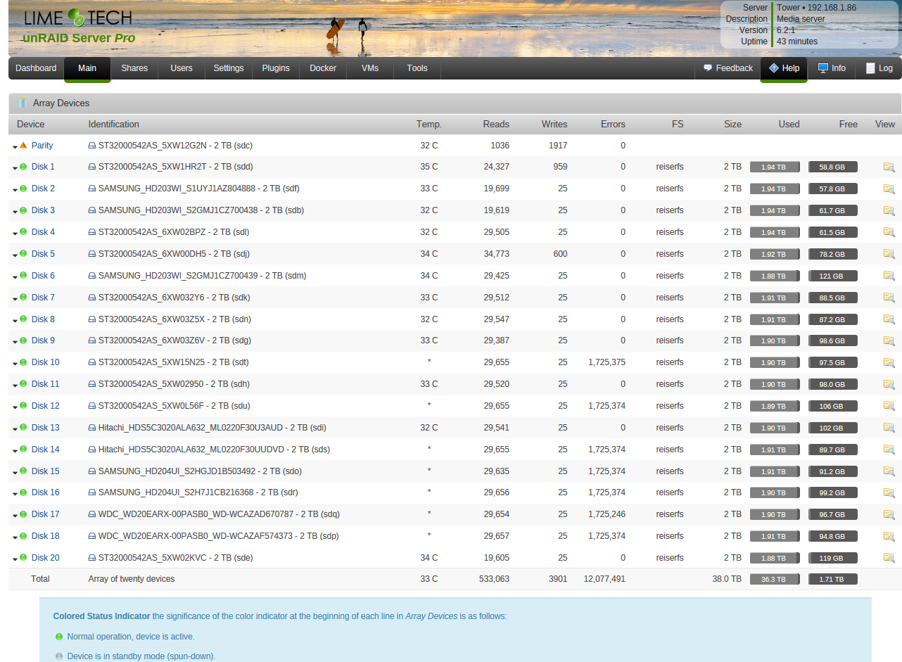

Just rebooted and they are all showing fine.  Just started the array and they all mounted fine too.
STRANGE ... especially if you didn't reseat anything and just did a reboot.
FIRST thing I'd do is let the parity check run to completion => you definitely want to get everything parity protected before doing anything else.    Then you'll need to run the New Permissions utility ... and then everything should be fine.
The next question is WHY you had the issue with the controller => it could have been (a) a fluke (one of those never-understood problems that simply go away);  (b)  a failing controller;  or ©  a failing power supply.    I'd be inclined to lean towards © ... but you may want to simply leave everything alone to see if the issue repeats itself.    But FIRST get good parity !!
To be safe I've just shut down the server, reseated all of the cables and rebooted again.  In my tower the usb drive is mounted just below the offending card...so I must have knocked it.
Parity was good before I did the upgrade.  The drives were showing fine to begin with, but once I started the parity rebuild the errors appeared.  The rebuild showed at 0.2% before I stopped it and posted on here.
Will that have affected any data on those drives, do you think?
No, it would have only messed up the parity => but a new parity check will resolve that.
