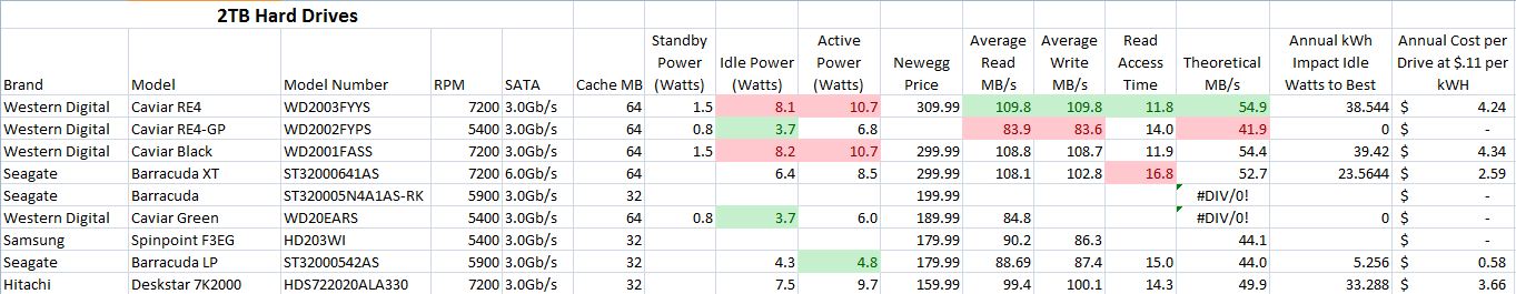

I tried to quantify my 2TB options with the attached matrix.  You will see that some data points were unavailable from the manufacturers.
Some things aren't quantified on this chart, such as the complaints on certain models - failure rate, noise levels, whining sounds (Hitachi, I think?).
The Hitachis are starting to look like a good deal at half the price of the Seagate XT...
