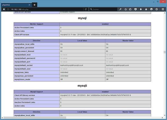

regarding PHP5 and mySQL, i see in the dockerfile you have the following:

I think php5-mysqlnd would be the module I'd need added. I was reading this guide which had a section for adding mysql for PHP5 in an nginx installation: https://www.howtoforge.com/tutorial/installing-nginx-with-php-fpm-and-mariadb-lemp-on-debian-jessie/
I'm missing the MySQL and MySQLi sections in my phpinfo page (see attached example from howtoforge link

There are a ton of php modules and we only included the most commonly used ones (so as not to bloat the image unnecessarily). We can add more modules as we get requests. I'll look into  adding a sql one before the next Friday update
Thanks!
