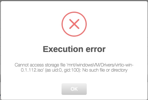

Actually I have figured out that everything I need is on my SSD, however when I try and start the VM I keep getting this error which I can't seem to fix.
make sure you re-downloaded the virtio drivers in the vm tab(if you don't have them already) and/or that you have the xml/vm creator/manager pointed to the correct folder/file.

I'm curious about something.
Where did the /mnt/WindowsVM mount come into being?  (Is this mount point on an unassigned device mounted via the UD plugin?)
Old versions of UD used to allow mount points such as that, but that feature was long ago deprecated, and IIRC if you try and recreate that particular mount point with UD it looks like it sort of works, but it doesn't.
All UD mount points are now (and have to be) within /mnt/disks/...
Yes Squid, its on an SSD which is an UD, this server is running unRAID 6.2.3 so it's not that old, I can't remember what version of unRAID I was running when I created the Windows 10 VM it may have been before 6.2 but the settings I have were working before I removed the disks, now I've put them back I am getting that error when I try to start the VM. Any clues as how I might fix it? I've checked the XML and everything is pointing to where it should, not sure what to do next.
You were bang on Squid, when I changed the paths to /mnt/disks it booted the VM, problem is now that is booting into Windows setup, I don't know why. Wondering what I should do, I don't want to lose my existing install, if I let windows install it shouldn't over write my existing install. Wonder why its booting into Windows setup?

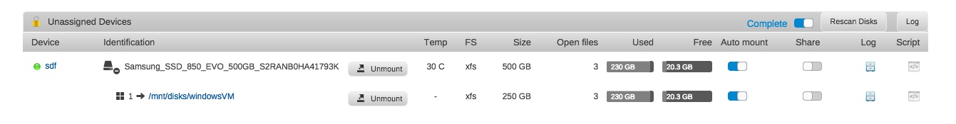

Where is the SSD actually mounted in /mnt/windowsVM or /mnt/disks/windowsVM?
If its now mounted in /mnt/disks/windowsVM then those 2 vdisks are actually stored in RAM....
Now I'm getting messed up.
Not sure I am entirely following all the nuances here. Seems to me /mnt/disks/windowsVM is on an unassigned disk and /mnt/windowsVM is in RAM.

I thought maybe something was in RAM too so I rebooted the unRAID server, nope, still have the two Windows 10 folders with the two vdisk images. After the reboot I tried to start up the VM again, and it booted, but into Windows setup again.
Yes, all my files should be on the SSD which is an unassigned disk.
