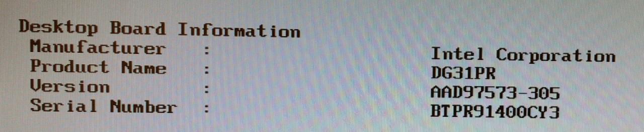

I was wrong about motherboard, it's an Intel DG31PR but I can't find info about 64 bit O/S at
http://www.intel.com/content/www/us/en/support/boards-and-kits/desktop-boards/legacy-intel-desktop-boards/intel-desktop-board-dg31pr.html

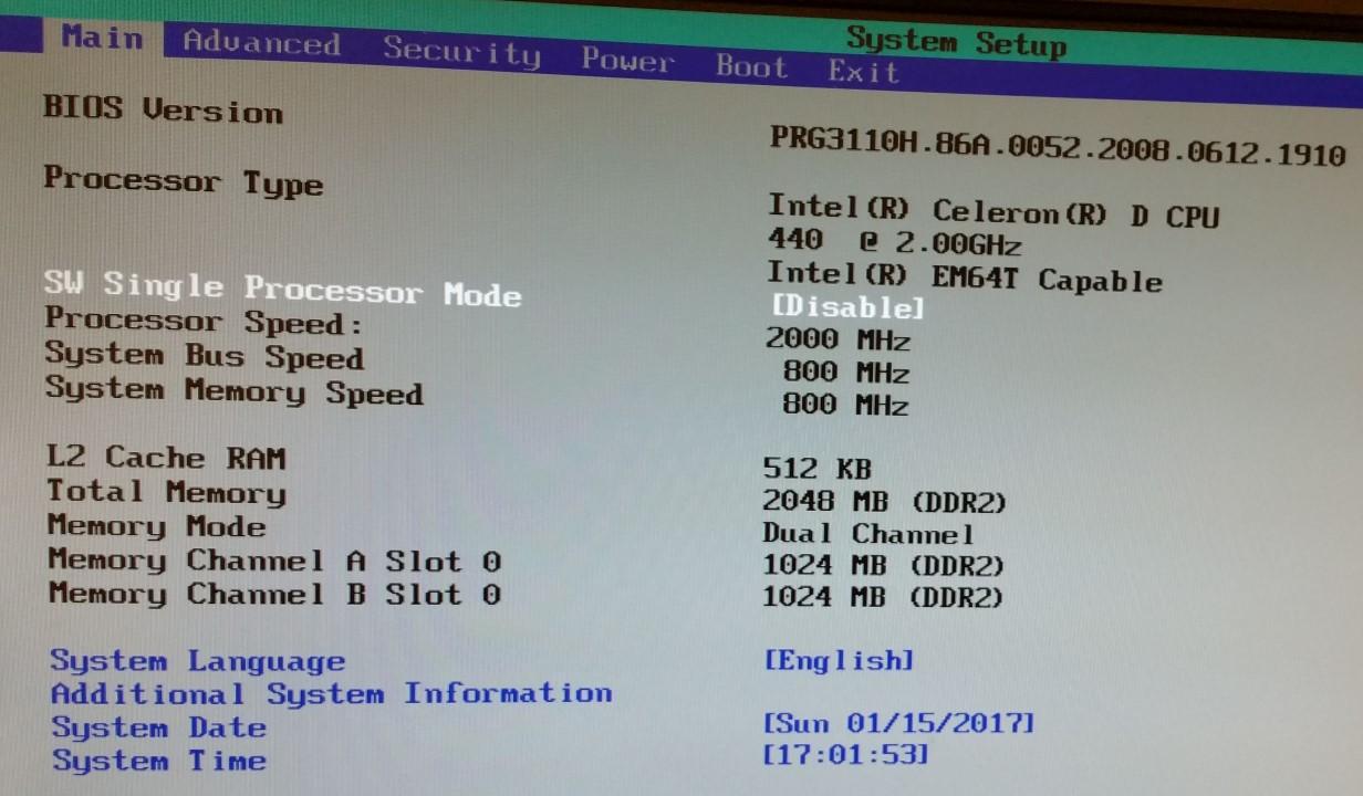

Just for grins, what is the CPU on the system that won't boot?    Although every CPU I checked on the "supported CPU" list for your motherboard was 64-bit capable, I have to wonder if I missed one that does NOT have 64-bit support.  Not likely -- but if you note the actual CPU we can absolutely dismiss that as the cause of your problem.
It's a 4400 Celeron D 2.0 Ghz
However UNRAID 5 was working fine before and now the USB with v5 put back on still won't boot to UNRAID.
A Celeron 4400 D 2.0 dosnt exist - the Board is a S775 - so what is it?
I suspect you have a Core 2 Duo E4400, which is being mis-identified by the BIOS because you didn't update it to a level that had proper support for that CPU.
It's also possible that you miss-typed the number and you have a Celeron E1400, which is also a 2GHz CPU
Both of those are on the CPU support list for your motherboard -- and as I noted earlier, all of the CPU's on that list DO have 64-bit support, so that's not your problem.

Ahh -- you have a Celeron 440.  So you didn't mistype the name -- just the number  :)
... and the Celeron 440 DOES have 64-bit support (as I've noted several times, ALL of the supported CPU's do for that motherboard)
