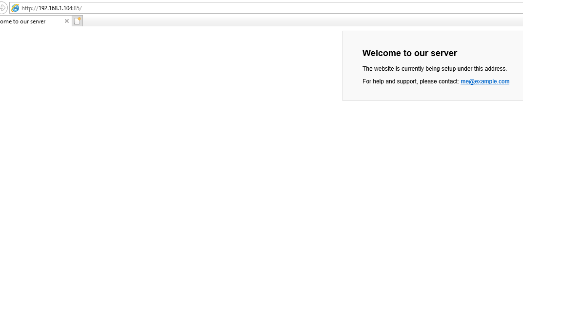

Unfortunately, my ISP tries to block whatever they can, and no other way to get them to cooperate.
run the nginx docker (by linuxserver without all the SSL letsnecrypt stuff) and map it as port 81 in docker then see if you can access the nginx web page from your ip and from your duckdns domain.
I guess this means it's working.  So Duckdns is having issue?
Got to go, but please leave me a message if you see this.

no you need to access it from your external IP or from your DNS not from the 192.168.1.104 address
so you need to forward port 80 on your router to 85 and then try it from your duck dns address
Edited by Fma965
Also, your example url shows the webserver answering on port 85, so for this test to be valid you need to change the internal port forward to 85 so it maps to the working server.
just edited to say that before you posted but yeah :D

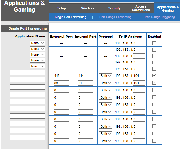

Hi.  It works!  I forwarded port 80 to internal port 85, and shows the same display screen above.  I accessed from outside the house, via IP, and via jxxxxx1.duckdns.org, with same successful result.  May I know what to do next?
Without changing anything in the router, try changing your LE docker to map container 80 to host 85 and see if it starts correctly. Obviously the plain nginx docker will need to be shut down.
Yup, it starts correctly.  But, not accessible.  Not the same as just plain Nginx
I take that to mean the LE logs no longer have the error about the certificate that you posted earlier?
Still the same.

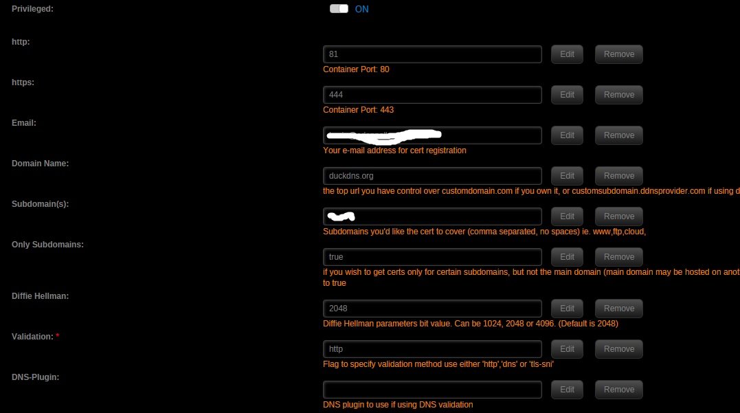

I am trying to follow the guide and I got through step 4 in setting up the Letsencrypt container but when I type 192.168.1.42:81 (unraidip:81) in my browser it just takes me to a page that says "This page can't be reached" instead of the nginx home page.
192.168.1.42 is my internal IP for unraid
HTTP set to 81
HTTPS set to 444
No ports forwarded yet since this is only internal at this point
What could I be doing wrong?

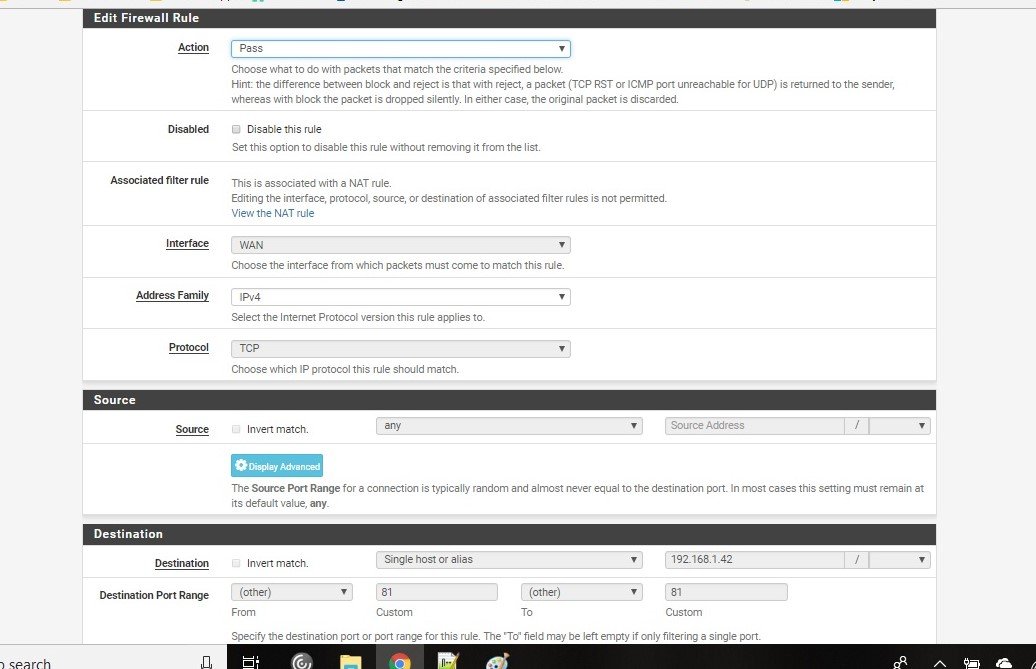

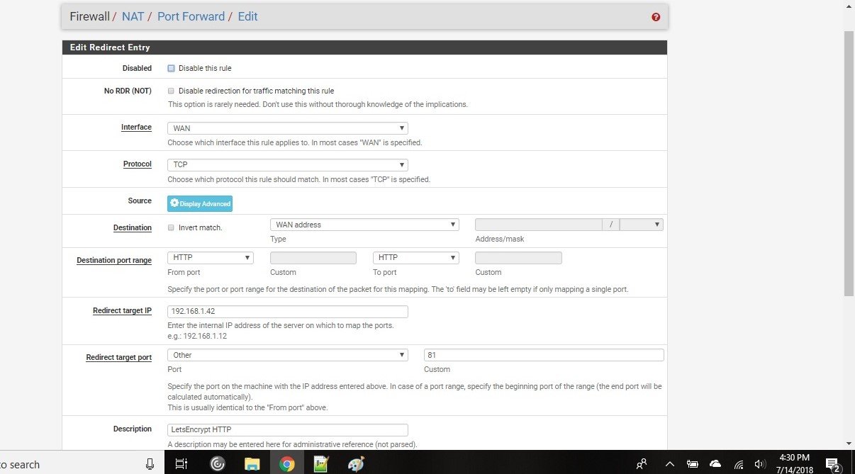

I went into to pfsense and forwarded port 80 to 192.168.1.42:81 and 443 to 192.168.1.42:444.  When I type 192.168.1.81 I still get the "Site can't be reached" page.  If I type mysubdomain.duckdns,org I get a Chrome "not secure" page and if I click proceed I get a pfsense error page that says "Potential DNS Rebind attack detected".
I also get this in my Letsencryot container log:
tls-sni validation is selected
Generating new certificate
Saving debug log to /var/log/letsencrypt/letsencrypt.log
Plugins selected: Authenticator standalone, Installer None
Obtaining a new certificate
Performing the following challenges:
Client with the currently selected authenticator does not support any combination of challenges that will satisfy the CA.
ERROR: Cert does not exist! Please see the validation error above. The issue may be due to incorrect dns or port forwarding settings. Please fix your settings and recreate the container
I'm sure I have something stupid wrong but I can;t figure out what.
VALIDATION http
you need to add that value to the docker
That seems to have fixed the error in the log but 192.168.1.42:81 still does not take me to the nginx default page.
its https you need to go to https://192.168.1.43:444 but really you should be accessing it from a domain externally even when internal

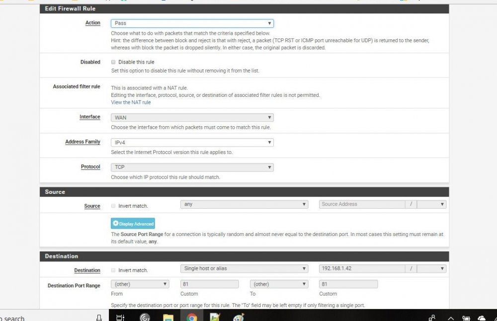

Here are a few screenshots showing my settings. I showed the NAt ans rule reated for HTTP.  The HTTPS entries are the same except 443 forwarded to 444.
Edited by RockDawg
Since I am getting the nginx 404 page, doesn't that mean that the request is getting through to the Letsencrypt container and therefore my port forwarding is working correctly?

Welcome to our server
The website is currently being setup under this address.
For help and support, please contact: [email protected]
