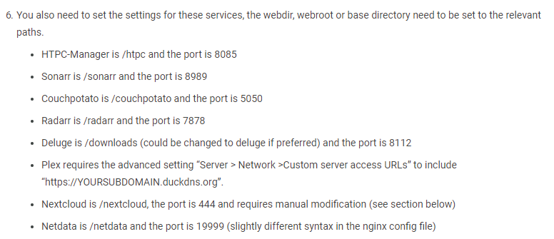

Hi @Fma965,
Thank you very much for writing this guide.
I have reached step 6 on the Nginx configuration page, and was curious what was meant by:
"You also need to set the settings for these services, the webdir, webroot or base directory need to be set to the relevant paths."
Best,
Rob
15 hours ago, cablecutter said:
Hi @Fma965,
Best,
Rob
You just need to make sure you have the "URL Base" set correctly, sometimes called a webroot or base url in the settings for the application, e.g sonarr is URL Base

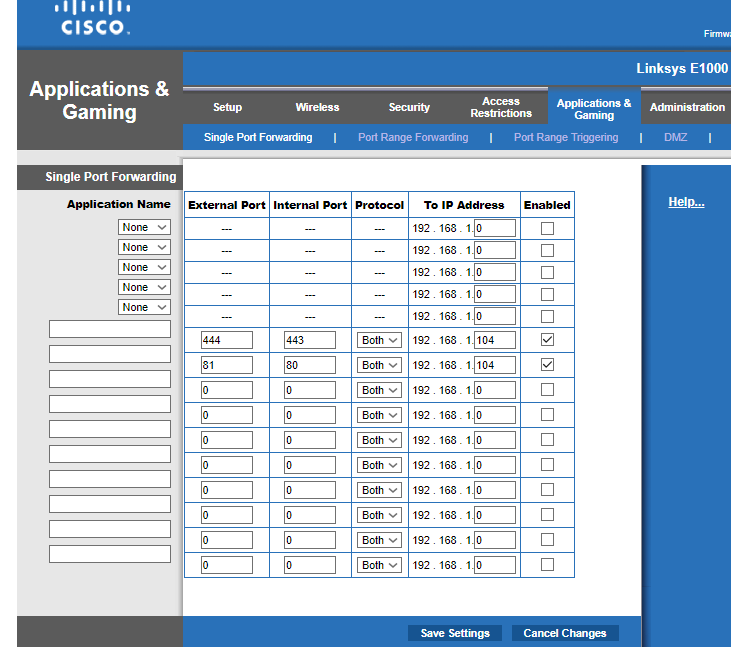

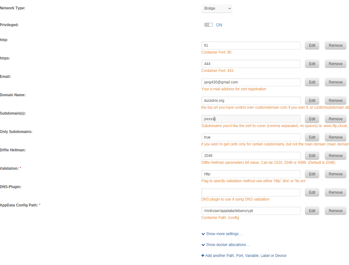

Hi.  I can't get this to work.  Logs on letsencrypt says:
Backwards compatibility check. . .
No compatibility action needed
2048 bit DH parameters present
SUBDOMAINS entered, processing
Only subdomains, no URL in cert
Sub-domains processed are: -d jxxxx1.duckdns.org
E-mail address entered: [email protected]
http validation is selected
Generating new certificate
Saving debug log to /var/log/letsencrypt/letsencrypt.log
Plugins selected: Authenticator standalone, Installer None
Obtaining a new certificate
Performing the following challenges:
http-01 challenge for jxxxxx1.duckdns.org
Waiting for verification...
Cleaning up challenges
Failed authorization procedure. jxxxx1.duckdns.org (http-01): urn:ietf:params:acme:error:connection :: The server could not connect to the client to verify the domain :: Fetching http://jxxxxx1.duckdns.org/.well-known/acme-challenge/PwoD5ycQWe5M5Azj-oXI-x0v60wOQmwllxm-fXr4Iio: Timeout during connect (likely firewall problem)
IMPORTANT NOTES:
- The following errors were reported by the server:
Domain: jxxxxx1.duckdns.org
Type: connection
Detail: Fetching
To fix these errors, please make sure that your domain name was
entered correctly and the DNS A/AAAA record(s) for that domain
contain(s) the right IP address. Additionally, please check that
your computer has a publicly routable IP address and that no
firewalls are preventing the server from communicating with the
client. If you're using the webroot plugin, you should also verify
that you are serving files from the webroot path you provided.
ERROR: Cert does not exist! Please see the validation error above. The issue may be due to incorrect dns or port forwarding settings. Please fix your settings and recreate the container
Hope some of you can shed some light.

Firstly thanks for adding so much info
You have your port forwards backward. should be 443 to 444 and 80 to 81 not the other way around.
Hi.  Sorry for adding so much info.  BTW, inverted the order, still the same error.
don't be sorry it's good.

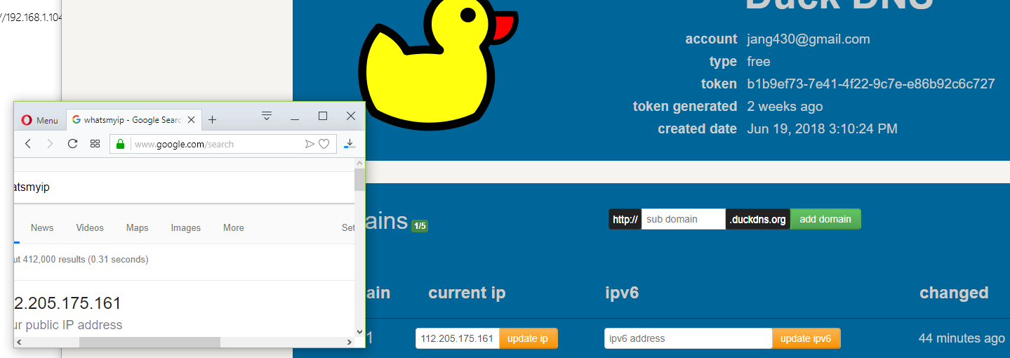

Then your dynamic dns may not be up to date with your IP. or your unraid isn't 192.168.1.104
Or your ISP may be blocking port 80 incoming.
Hi.  But it is.  I also restarted my duckdns docker container.
yeah it could be your ISP is blocking port 80 / 443 incoming
Anything I can do with it?  Any other confirmation I can do?  I'd really like to get this working.  Did I do everything right so far from posts above?  Maybe I made some slight mistake :D
contact your ISP, everything else looks fine, send me a updated screenshot of your router port forwarding just to be sure.
