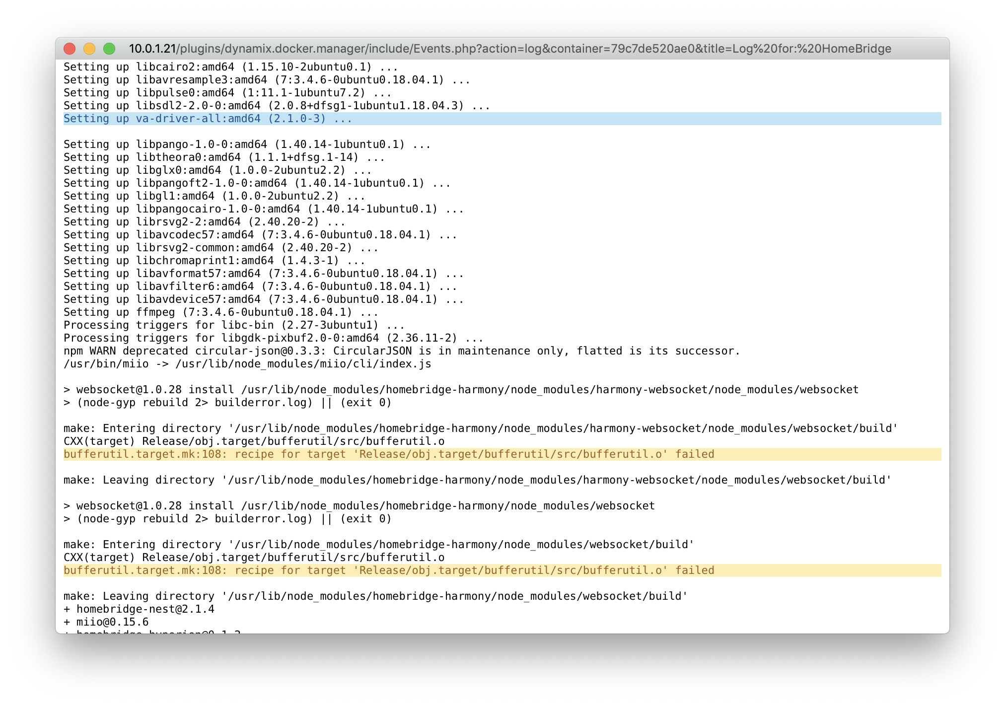

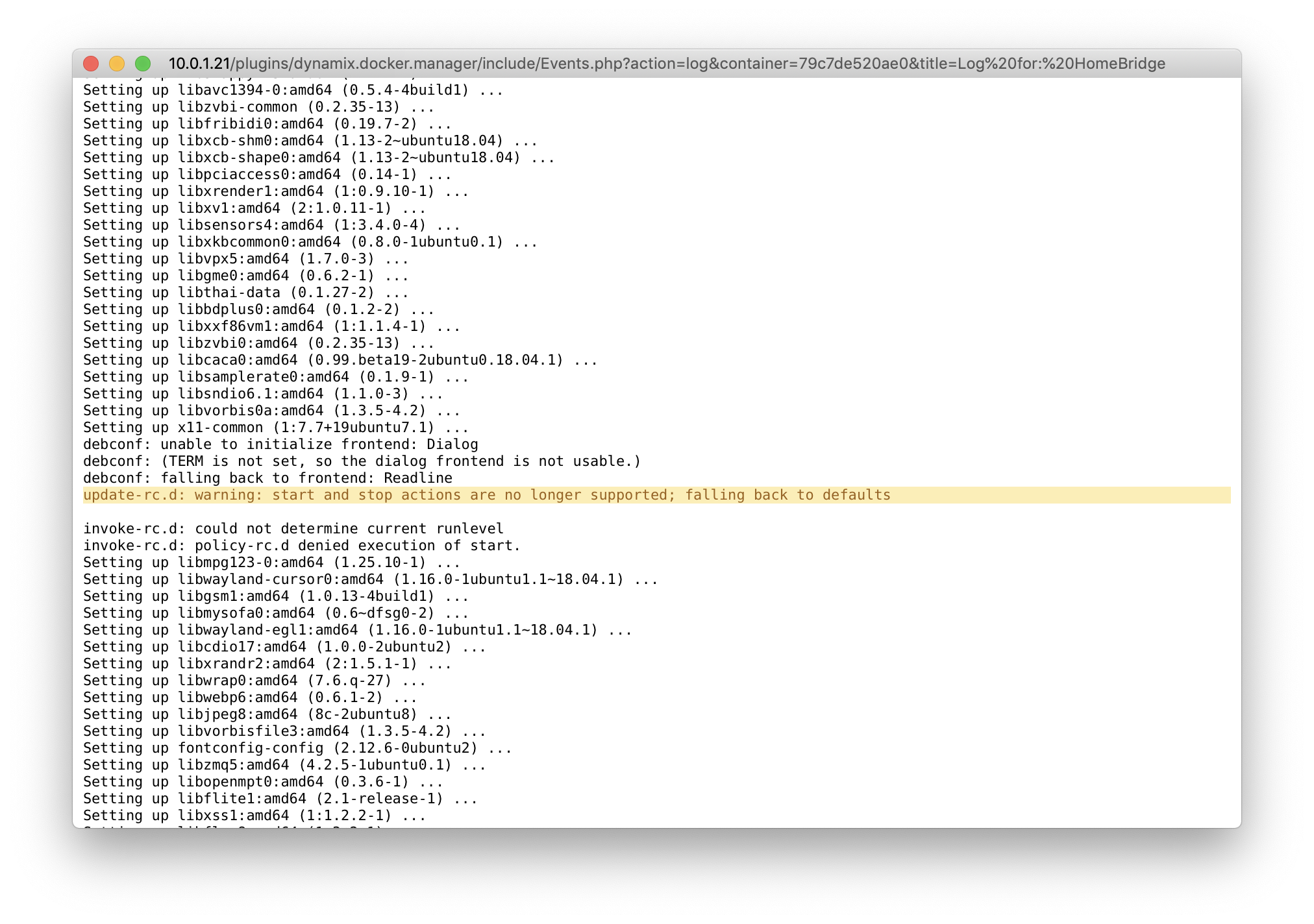

  5. I've narrowed it down to the Nest plugin. No changes whatsoever related to my Nest config - anybody have any ideas? I've completely removed the docker/nuked its appdata folder and completely rebuilt. Same issue - if I remove nest it works great. WTF! lol I've even issued a new api token! Anybody hear of any issues with Nest? I can't seem to find much... thanks all!
  6. these are the 3 errors. the one from my OP just reads as text (not colored). thanks!
  7. is this what you're looking for? the error would be the last line - takes awhile to show up so it's not in this one. thanks! homebridge.log
