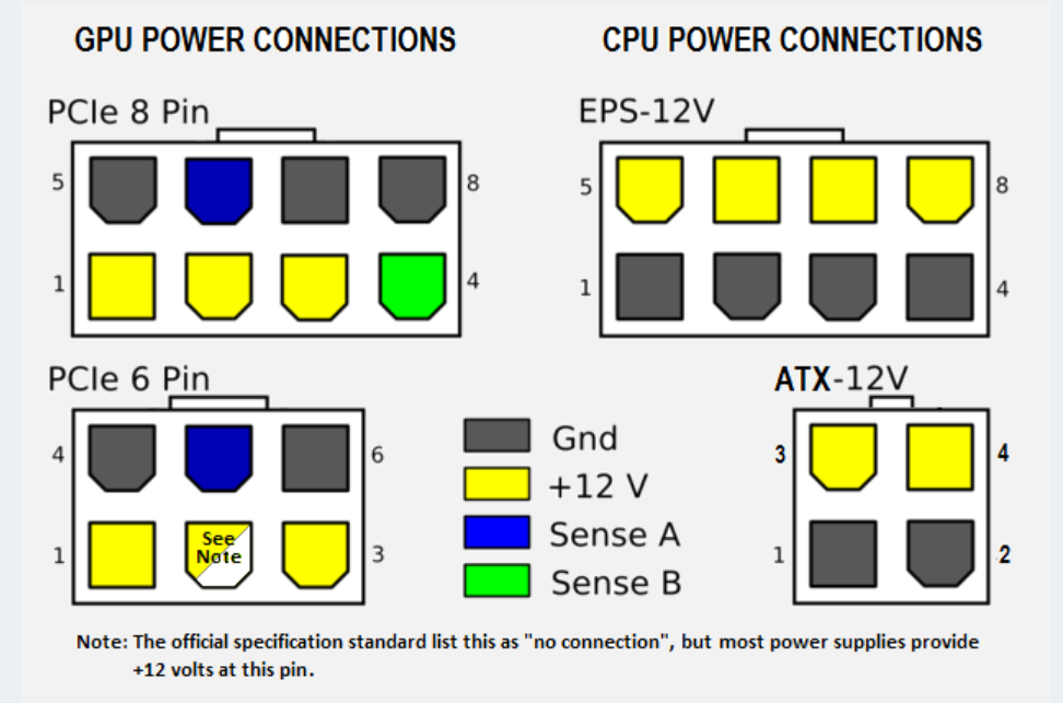

One thing I can't tell for sure in the photo => seems VERY unlikely you'd have made this mistake ... but are you CERTAIN the power leads you've plugged in to the CPU-Aux power connectors (the 8-pin connectors) are the EPS12v connectors and NOT 8-pin PCIe connections (which have DIFFERENT voltage outputs).

You can't fit a PCI-E connector on the CPU AUX or vice versa, they are keyed differently, good thinking from someone  :)

They're the correct cables. They are labeled CPU on both the old and new PSU.

... You can't fit a PCI-E connector on the CPU AUX or vice versa, they are keyed differently, good thinking from someone  :)
I actually thought that was the case, but wasn't at home when I wrote that and couldn't look at a PSU to confirm it.
