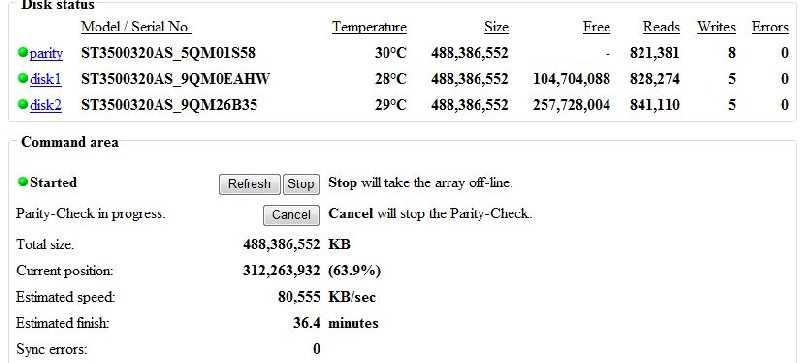

Good temps with most of the fans running at 70%.
