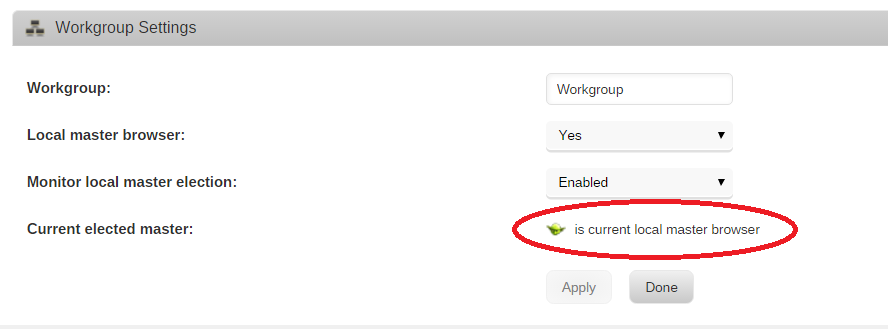

I'm getting the feeling that samba is simply not starting. One time, and one time only, did this list the unraid box as the master server. Now it's just blank. Refresh, blank. Reboot, blank. Stop and start samba via the UI, blank. Previously, my laptop was listed here.master.png.d89acb8e271523e4ee5f2b139cf922fe.png

After that, the unraid box shows up as the master server again. (Still can't access the shares)
