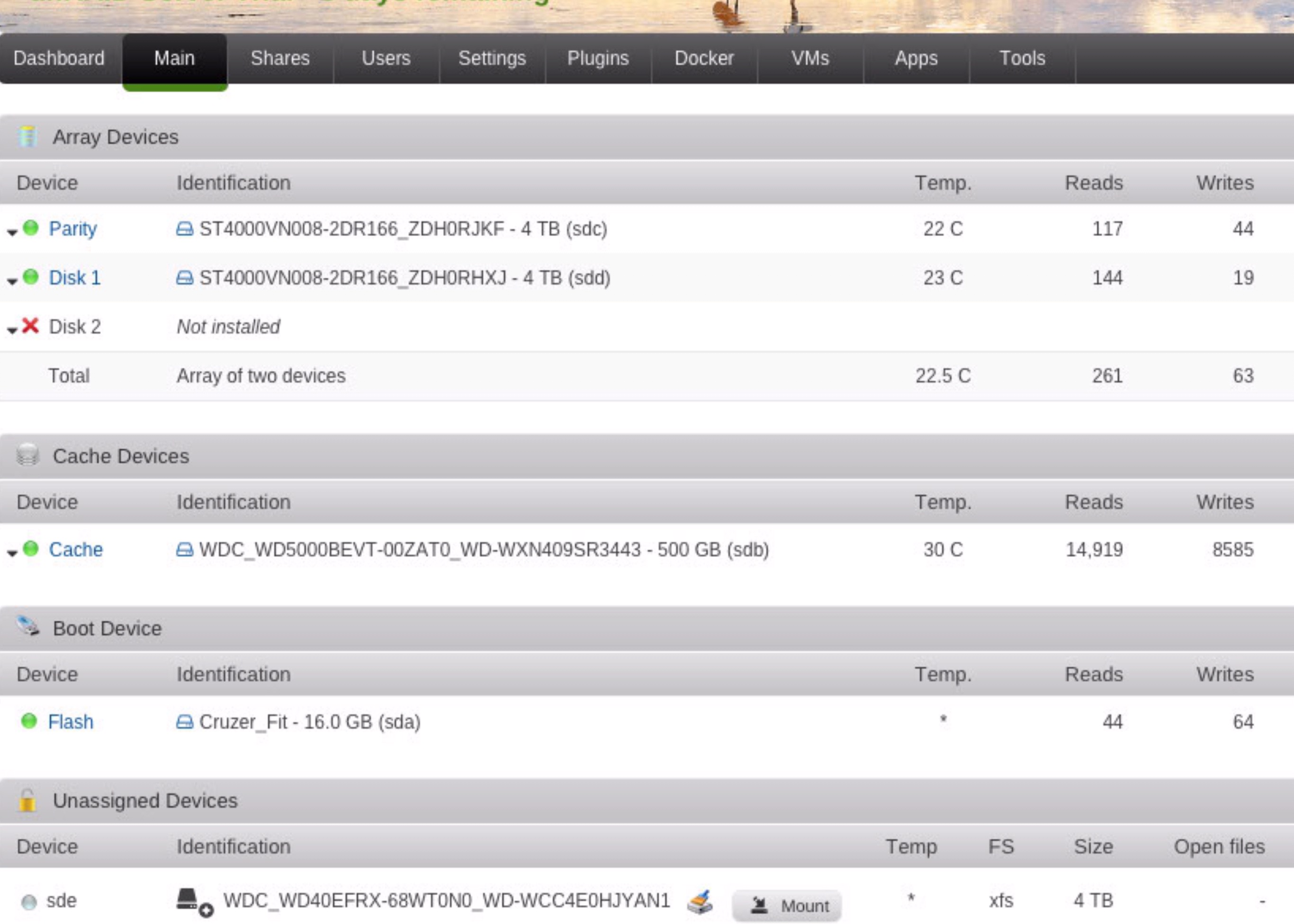

No actually I had to remove a drive temporarily. I was able to start the array nevertheless. I can see the content of the missing disk, even if I can not "use" any of it.

I accidentally deleted some files on one of my disks. So I removed it from the array to rescue the deleted data, which went fine. I didn't do any changes to the disk itself though.
Since I wanted to use my unraid server while restoring the data, I startet it with a missing disk (I have a cache drive, a parity drive and two array drives). Now having the data restored on an other disk (not part of my unraid system) I want to add the removed disk to my array again.
But before I add the disk and start the array, I'm curious what's going to happen?
I thought that unraid will remember what the missing disk contains and just work without it meanwhile. When adding the disk again I can access the files and add new data to the drive.
Or should I add the drive and rebuild the parity disk?
First, it's not at all clear why you removed the disk in the first place.   But given that you did, what will happen is that UnRAID will rebuild the disk back onto itself when you restore it to the array.    This will include any changes you might have made to the emulated disk (if you didn't write anything to the emulated disk, then the disk should be exactly as it was when you removed it).   Note that if you had any cached data for a share that includes the removed disk, there may have been files written to the emulated disk as a result of the mover process.
In any event, simply re-assigning the drive and letting UnRAID rebuild the disk is most likely what you want to do.
The other option -- if you're confident the disk is good -- is to do a New Config and let parity be rebuilt, but this would put your system "at risk" (not fault tolerant) during the parity sync.
