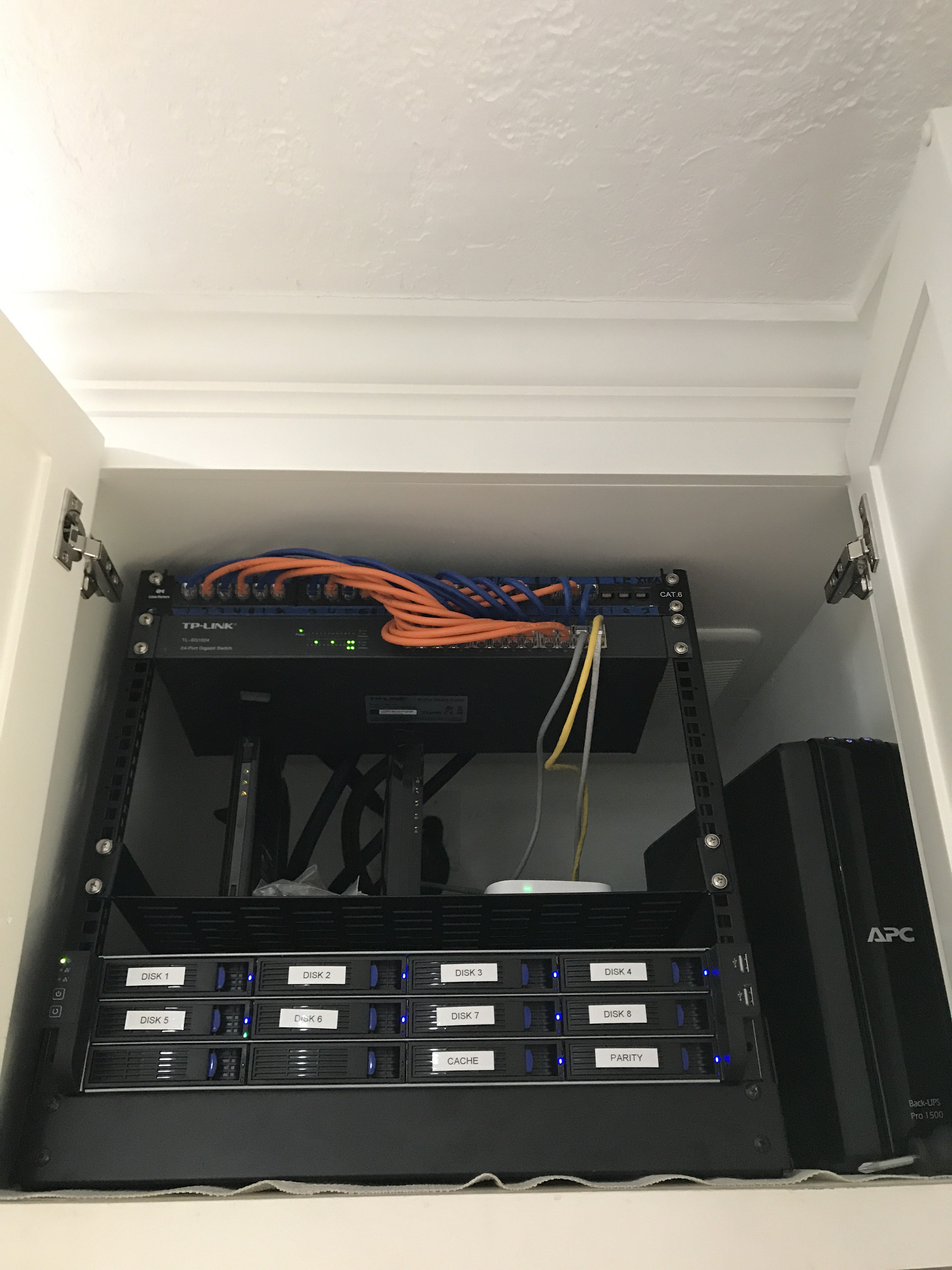

i'm looking at your server pictures - those HDD labels on the front, is this  good idea, cos some went holes i think is partially blocked?
I've been monitoring the temperatures, mostly because I was curious how it would do in that network closet. . . .
. . . . . doesn't seem to be affected.
The case is kinda cheapy. . . . . it's not a supremely tight fitting front end :)
Thanks
