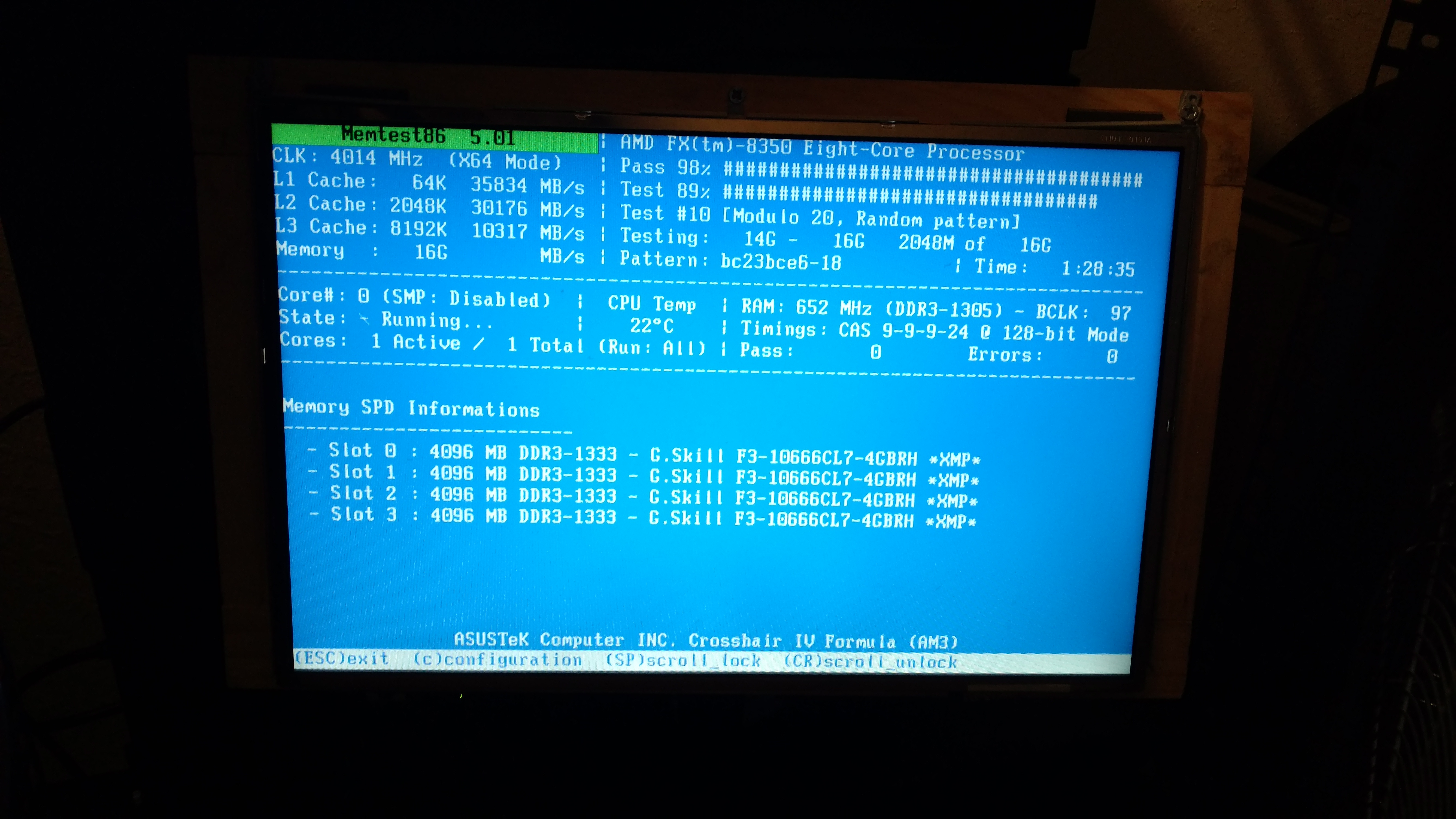

Memtest is a going...
First pass came up clean with no errors. Letting it run for another pass. I'm thinking my drive is screwed...

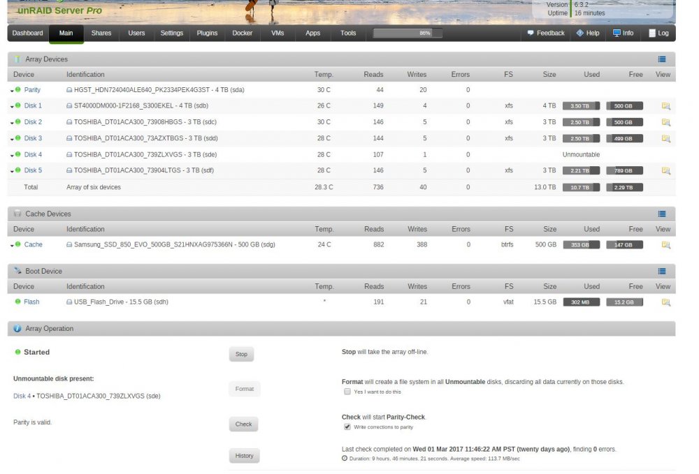

I'm a bit intrigued by your statement of a 19 day old parity copy, but didn't understand what you mean by that.  Is that a *separate* disk that you can put back in?  And was Disk 4 fine at that time?  What exactly do you have from 19 days ago?
Also, you have IDE emulation turned on for your onboard SATA drives.  When you next boot, go into the BIOS settings and look for the SATA mode, and change it to a native SATA mode, preferably AHCI if available, anything but IDE emulation mode.  It should be slightly faster, and a little safer.
You have Disk 4 and Disk 5 on the same IDE channel, at limited speed.

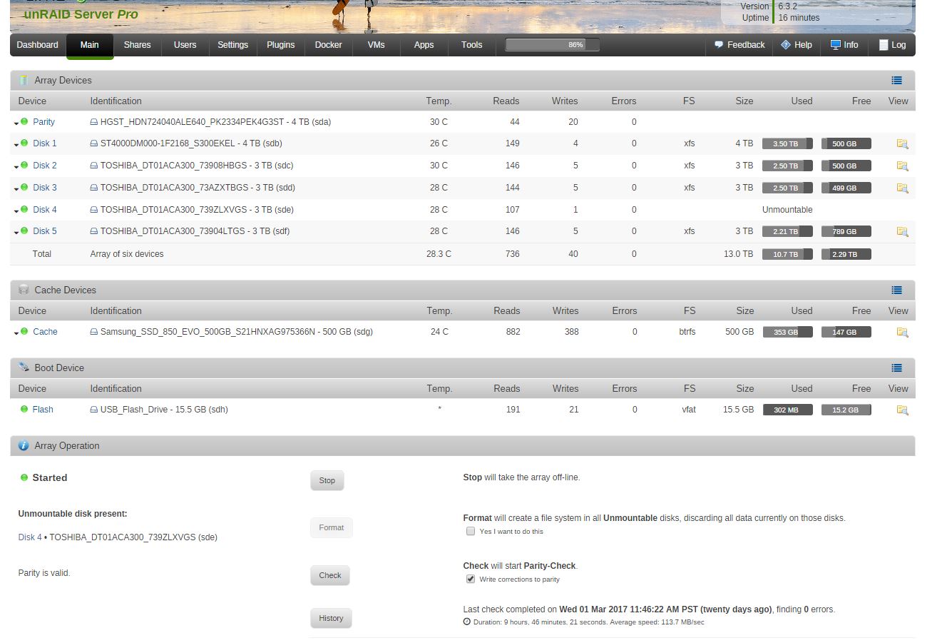

I have a parity drive in the unRaid that says its 19 days old. Am I understanding the parity wrong? I thought it was there so if a drive died it could re-build it, unless it has the file system corruption is on it as well. Should I be running the parity check more often?

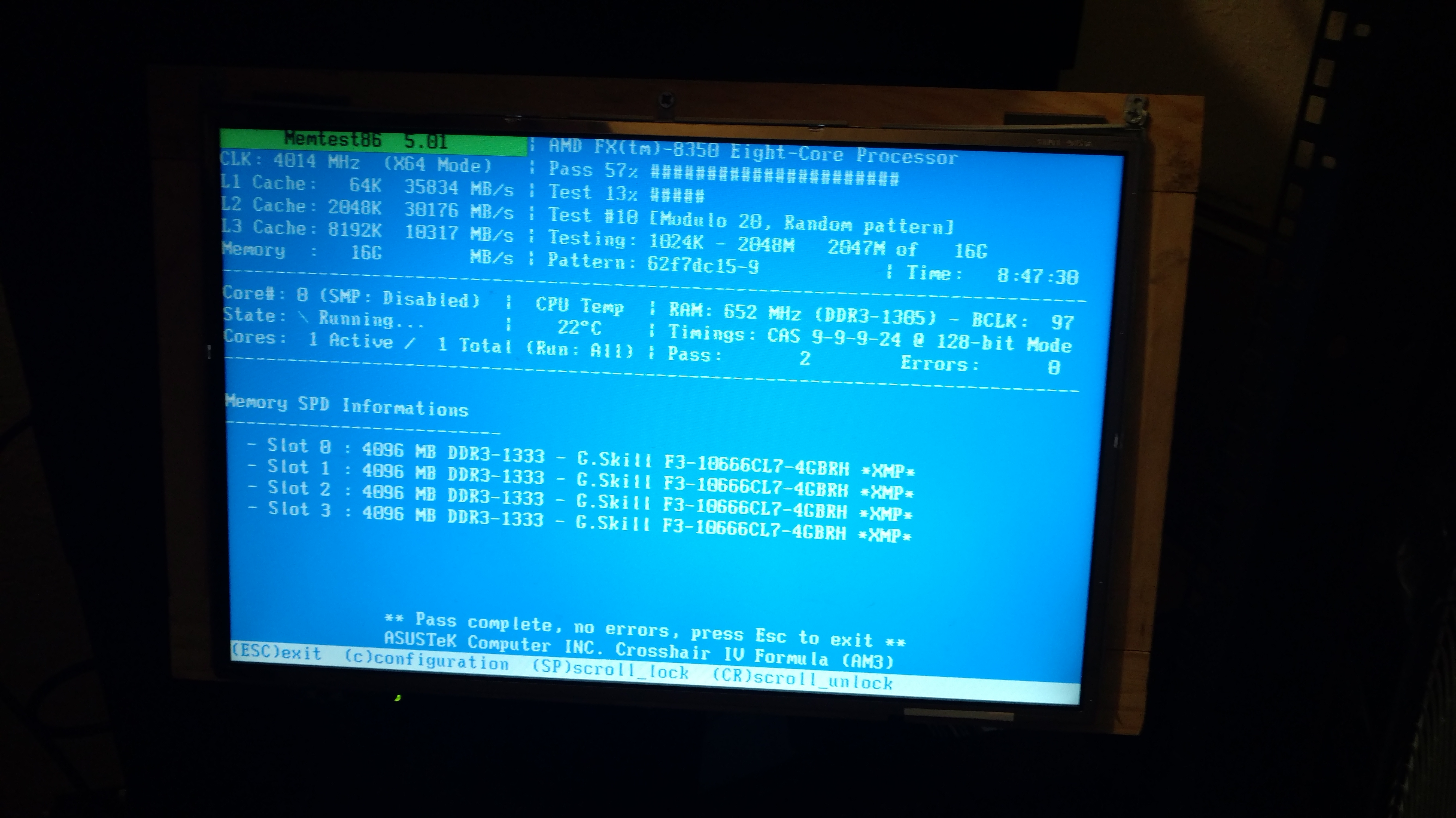

Memtest did 2 passes with no errors so I'm going to say it is the file system on Drive 4.
Here is a screen from the Memtest that has been running most of the day - 58d208d31f571_Memtest2_20170321.thumb.jpg.3f2ba26120c240920730f5771514b38a.jpg
Here is a screen from unRaid that shows the Parity was last checked 20 days ago with no errors. As far as I know everything was up and running then. I did an update a few days ago and that is when I got the Un-mountable Disk. I tried to run a check on that disk in maintenance mode and then I ran one with -L and here I am now.
