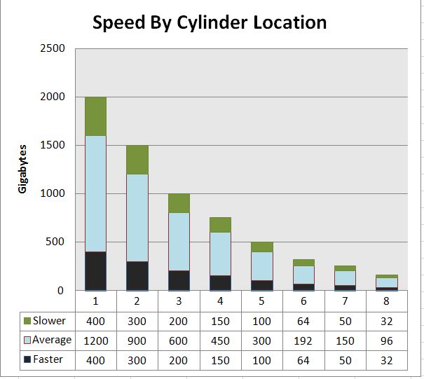

Here's a chart to help visualize how the drive speeds vary over the cylinder locations.

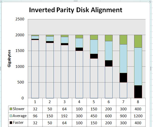

The second chart shows how the drives would be aligned if the parity were calculated in the way the OP suggested.
While it's true that the parity drive would become the only really important speed limiter, it would also mean that the fastest part of the parity drive might go unused if the data drives were all smaller.  That alone seems a high price to pay, too high I think.
