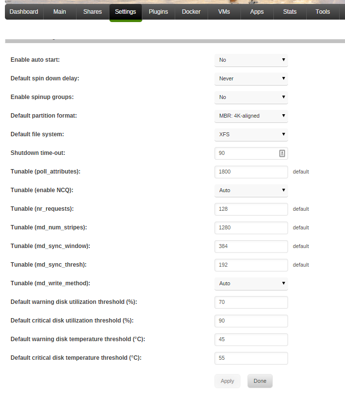

Tun turbo write on, aka reconstruct write (settings -> disk settings)
I don't see that option in my disk settings.
Found it.
Tips for Performance
This section is specifically for tips that may help users of current versions run faster, but hopefully just as safely
Turn on Reconstruct Write
(Highly recommended! Often called 'Turbo Write' )
Problem: Writing to parity protected data drives has always been slow, because it requires reading the old data and parity blocks, calculating the new parity, wait for platter rotation to bring the block location back around, then finally writing the data and parity blocks. This is known as 'read-modify-write' (RMW for short). A new mode has been added to unRAID called 'reconstruct write', where the data is immediately written, all of the other data disks are read, and parity is calculated then written. There is no wait for platter rotation! And no double I/O to each drive (first the read then the write). Rather than modifying parity as before, it's building it fresh.
Discussion: There's an upside and a downside to this change. The upside is it provides a huge performance boost to writes directly to array drives! Users often see speeds between 2 and 3 times as fast! (That's why it's sometimes referred to as 'Turbo Write'!) The downside is that ALL of the array drives must be spun up for EVERY write! So it's a trade-off between write speed and drives staying spun down.
Suggested fix: go to Settings then Disk Settings, and change Tunable (md_write_method) to reconstruct write
Note: the tunable option Auto currently just sets reconstruct write to off
Tip status: highly recommended! it's a fairly new feature, but so far, no reports of problems
