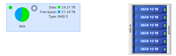

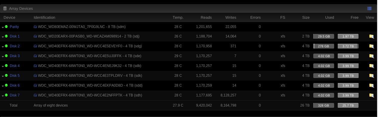

thats the current systems my old Nas an RN516 I am dumping all the data to the unRaid server then adding 4x of these drives to the array and using the other 2x as the dual parity setup.
5ab8dbb89c4fc_ScreenShot2018-03-26at7_37_42AM.png.0d73df507885749d82cf3ffdcf847ae1.png5ab8dbb41d23b_ScreenShot2018-03-26at7_36_47AM.thumb.png.733248064df9b1a5860e306fcfda25f4.png
It more clear.
Big job, migrate to unRAID, data move out and in.
For your case, I will propose some differnet way. ( If your plan was 11+2 disk array, instead 7+2 )
- Your old NAS was RAID-5, if you plug-out 2 disk then all data in those 10TB disks already invalid.
So I will do this ( Protection still maintain by the old 8TB parity disk and those 2T /4T data disk )

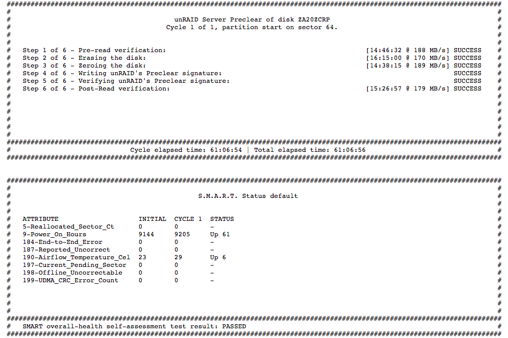

thats the results of the Preclear of one of the 10TB drives
5ad12085d8218_ScreenShot2018-04-13at5_24_44PM.png.3613c7edb0a6193c27c24199c6587dbb.png
High performance drive, each phase complete less then 17 hrs.
