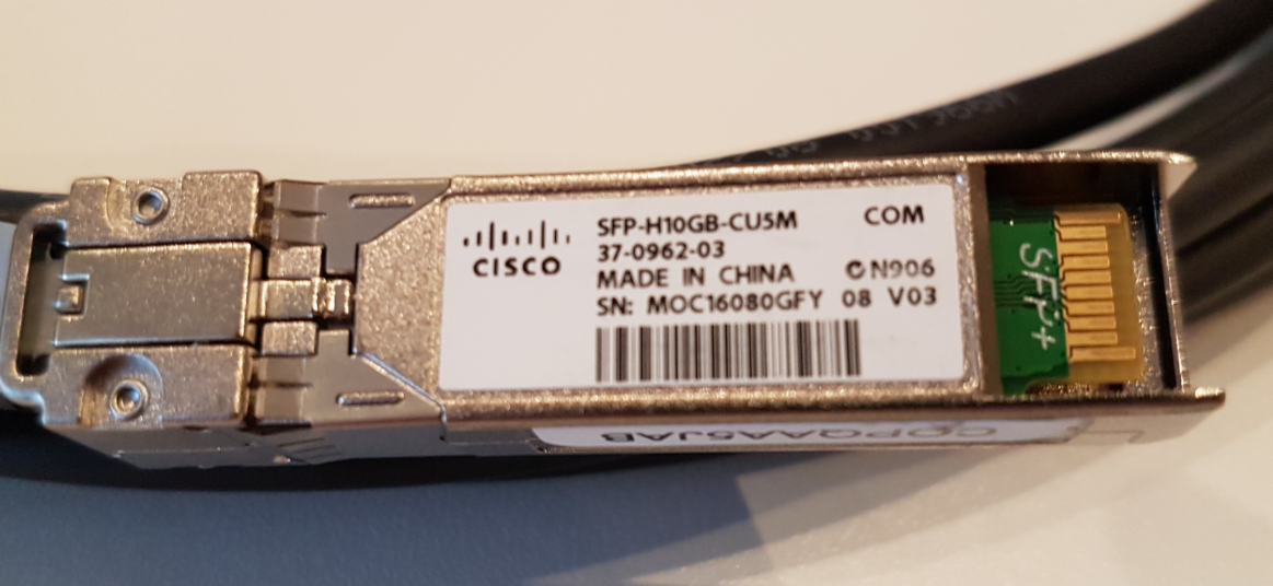

i use sfp+ DAC passiv, cisco, tested with intel (says the dealer, but he seems to know what he is saying)
and Router is recognizing connection to card, also the LED´s on the card are both lightning up (showing 10GB connection).
so when i understand this now, u say the driver is in the kernel and probably not compatible with this card ?
and should the Transreceiver module even count ? cause makes no difference here in logs if theres one inserted, if its connected, ...
all i see in the router it shows connected and the LED´s on the card show connected with 10GB speed.
if its card related im again ... i ll try then to get me an not branded Intel card, really sad for the dealers ... i dont like asking for replacement ;)
So, driver should be there, but may cause its the supermicro card with that chipset it aint working, i understand that correctly ?
I'm asking because I found this post:
https://sourceforge.net/p/e1000/bugs/399/
The driver itself has long been included with unRAID OS.  What you might try is use this command to see if the driver gets loaded:
modprobe ixgbe allow_unsupported_sfp=1,1
