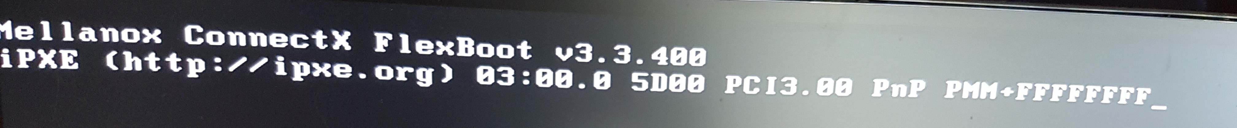

my new hardware arrived and with the connectx-2 i have a issue while booting, may someone here has an idea ;)
card probably wants to network boot, and i cant find a way out ... as soon i plug in the card boot stops here (see attachement)
also cant access my bios anymore, says setup loading but stalls on this screen directly after ...
tested on 2 different pcie ports ... sme behavior, may some bios setting i have to do before mounting the card,
boot option is only set to USB, all others are disabled ... may it activates itself while new NIC is discovered,
bus as i cannot enter the bios anymore nor the boot menu im stuck ... :/
tried all kind of keys including ctlr + .... nothing happens, only power cycle ...
For any tips thanks ahead ;)
Edited by alturismo
That should appear for 1 or 2 seconds and go away, I believe there's an option to disable it by flashing it, but never tried it since it doesn't bother me.
