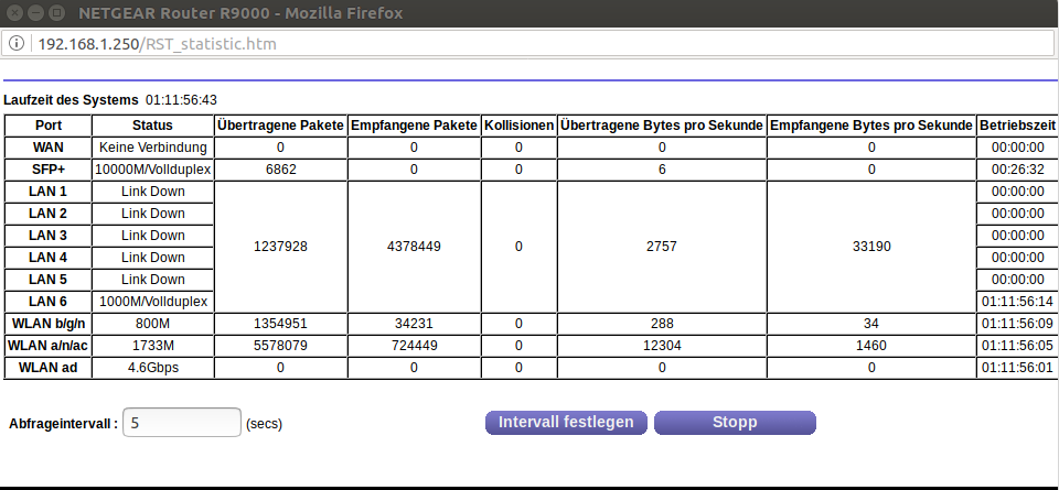

also same, router says connected (pic) ... so hardware seems ok, no driver support.
