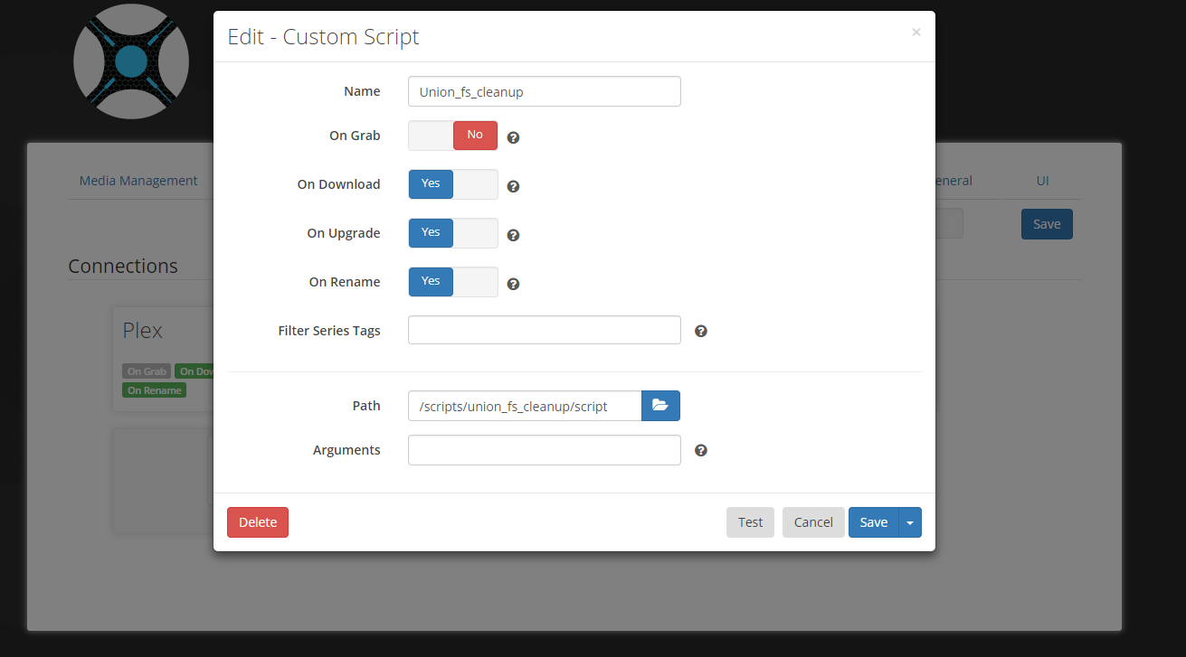

Also when you have a chance can you post about how you have Sonarr and Radarr run the union cleanup script? Thank you again.
I install the rclone plugin via a script as I have a pfsense VM so I can't use the main plugin as it needs connectivity when unraid starts, whereas I don't have connectivity for a min or two until my pfsense VM kicks in.
I have that install check there to make sure that I don't run the script twice - it creates a dummy file when the script starts that it checks isn't there before starting, and removes it when the script stops.  Once things settle down a bit, I'm going to set the script to run say every 5 mins so if for some reason the mount drops, it will re-mount it.
In radarr/sonarr you can run scripts in settings/connect and then add 'Custom Script'.  I just created an extra docker mapping for /scripts --> /boot/config/plugins/user.scripts/scripts/ .  I did it this way as I might have extra scripts in the future.
663915344_FireShotCapture129-Settings-Sonarr-https___the-shepherds.com_sonarr_settings_connect.thumb.png.bb1763d8154e059c358098c1bcc095a5.png
Awesome, thank you for all the help. Working great so far.
