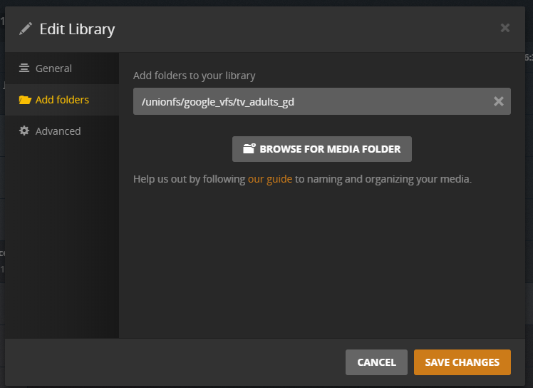

27 minutes ago, Kaizac said:
I'm afraid something is going wrong indeed. It's still transferring on the mount logs, Sonarr can't import since it has access denied. But I did everything like you, only I use /mnt/user/Media instead of /mnt/disks. Really frustrating.
have you got any apps other than plex looking at your mounts e.g. kodi, or maybe one of your dockers is not configured correctly and is mapped directly to the vfs mount rather than then unionfs folder
No other apps. I'm going to start over again from the info you just provided. Can you tell me how you did the /tv and /movies mappings in Sonarr and Radarr? And Did you add /unionfs as RW to these dockers just for permissions?

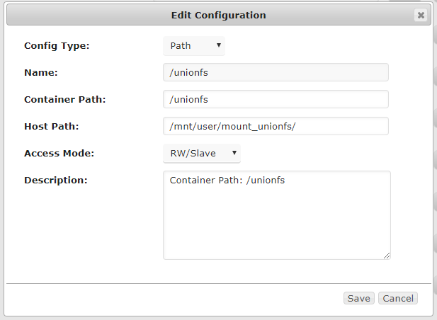

I added /unionfs mapped to /mnt/user/mount_unionfs RW slave in the docker mappings, and then within sonarr etc added the relevant folders e.g. /unionfs/google_vfs/tv_kids_gd and /unionfs/google_vfs/tv_adults_gd and in radarr /unionfs/google_vfs/movies_kids_gd , /unionfs/local_media/movies_hd/kids etc etc
Edited by DZMM
10 minutes ago, DZMM said:
I added /unionfs mapped to /mnt/user/mount_unionfs RW slave in the docker mappings, and then within sonarr etc added the relevant folders e.g. /unionfs/google_vfs/tv_kids_gd and /unionfs/google_vfs/tv_adults_gd and in radarr /unionfs/google_vfs/movies_kids_gd , /unionfs/local_media/movies_hd_kids etc etc
Sorry, I don't understand what you mean with "I added /unionfs mapped to /mnt/user/mount_unionfs RW slave in the docker mappings". Do you mean in the individual docker settings. Or is there some general docker mapping?
And looking through your scripts I only see movies covered. Is that correct? So did you stop splitting you upload folders for movies/shows?
And I also don't understand why you are binding. I understand your situation is different with a UD used for torrenting, which I don't have/need. But I'm not sure how to translate it to my situation.
And did you also change something in your Sabnzbd mappings?
Sorry for all the questions, I'm feeling quite imcompetent at the moment.
Edited by Kaizac
2090057096_FireShotCapture1-Highlander_UpdateContainer_-https___1d087a25aac48109ee9a15217a1.png.1027c93065e2b38bb984ab99f11f7e2e.png
Thanks for the info again. Did you do the above in the individual dockers? If so, how would Sonarr look for example? Did you point /tv to /unionfs/TVshows for example and then also add /unionfs as RW Slave like the above?
All dockers as per the image - so that they are all referencing the same mapping which is important to have good comms between dockers.  Within each docker I added the relevant sub-folders e.g. here's one of my plex libraries:
1527247881_FireShotCapture2-Plex_-https___the-shepherds.com_plex_inde.png.9b30e1ba5d8d80f3360855cc65b67f67.png
Edited by DZMM
