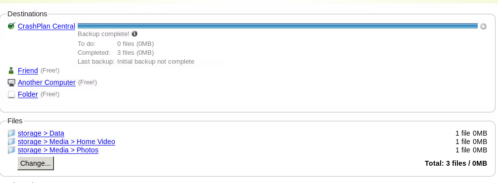

I just switched from the other docker because of problems.  Unfortunately, it seems I'm having similar problems with this docker.
I adopted my previous backup.  Now, however, it is showing each folder as only having 1 file and 0 MB.
Looking through the logs, I believe this is the pertinent information:
Not sure to understand.  Can you provide a screenshot showing the issue?
Thank you for the quick reply!
Here it is:
Note there is at least 3TB combined in those three folders.  Also, when browsing via the "Change" button, the files and folders are visible.
You probably have a problem not related to the container...
Did you kept default container settings?
What are the files permissions?  You can run these command from your unRAID server:
docker exec CrashPlan ls -l /storage
docker exec CrashPlan ls -l /storage/Data
Thanks again.
Yes, it appears to be something wrong with the folder structure under /user/appdata/CrashPlan - left over from the other docker.  When I uninstalled that docker, I was able to remove /user0/appdata/CrashPlan but could not remove /user/appdata/CrashPlan.
When installing this docker, I did keep all default container settings.
I just checked the service log and this looks related:
[09.06.17 10:53:08.249 WARN  8287_BckpSel .backup.manifest.ManifestManager] Exception initializing ManifestManager com.code42.backup.manifest.BlockManifestRuntimeException: BMF-ERROR: Failed to make block archive directory! /usr/local/crashplan/cache/42/cpbf0000000000000000000, exists=false, isDir=false, ManifestSiloManager@2091880427[ manifestPath = /usr/local/crashplan/cache/42, open = false]; MM[BT 794431381083289193>42: openCount=1, initialized = false, dataFiles.open = false, /usr/local/crashplan/cache/42], com.code42.exception.DebugException: Exception initializing ManifestManager com.code42.backup.manifest.BlockManifestRuntimeException: BMF-ERROR: Failed to make block archive directory! /usr/local/crashplan/cache/42/cpbf0000000000000000000, exists=false, isDir=false, ManifestSiloManager@2091880427[ manifestPath = /usr/local/crashplan/cache/42, open = false]; MM[BT 794431381083289193>42: openCount=1, initialized = false, dataFiles.open = false, /usr/local/crashplan/cache/42]
STACKTRACE:: com.code42.exception.DebugException: Exception initializing ManifestManager com.code42.backup.manifest.BlockManifestRuntimeException: BMF-ERROR: Failed to make block archive directory! /usr/local/crashplan/cache/42/cpbf0000000000000000000, exists=false, isDir=false, ManifestSiloManager@2091880427[ manifestPath = /usr/local/crashplan/cache/42, open = false]; MM[BT 794431381083289193>42: openCount=1, initialized = false, dataFiles.open = false, /usr/local/crashplan/cache/42]
Running the commands you suggested show full permissions:
I would definitely try to start with a clean, empty appdata folder.  Try to see if you have the appdata folder under anything in /mnt: ls /mnt/*/appdata/CrashPlan.
Worst case, edit the container settings and change the appdata mapping.
I couldn't remove /mnt/user/appdata/CrashPlan/, but I did change the settings to map to /CrashPlan2.  Also, I bit the bullet and did not adopt this time, starting fresh.  Painful to upload everything from scratch, but at least it's working.
Thanks again, highly appreciated.

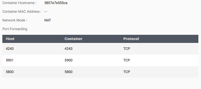

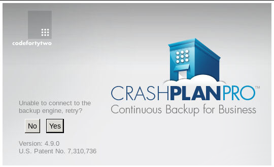

I do have a slight issue tho. Upon setting up the container everything works fine. its only when the container is restarted things go a little side ways.
When I restart I get the engine not found message, and I also notice the ui_info file changes. I've tried giving the ui_info file read only permission but still get the same results when restarted.
4243,aa19c4d7-36c9-4dfc-af04-01f51fc1cb99,127.0.0.1 (works fine)
then when restarted
4243,81f08a16-6c87-4efb-91ad-ee53df01c8cb,192.168.1.200 (doesn't work and IP changes to my NAS IP)
Can you help?
Im using QNAP Nas btw
I assume that docker's network is configured in bridge mode?  Did you added a mapping for port 4243?
My settings show as follows:
Network Mode : NAT
Host      Container    Protocol
(blank)  4243             TCP
5901     5900             TCP
5800     5800             TCP
Same results :-(

And it doesn't work even after you click "Yes" to retry?
Yeah still no joy, says connecting... for about 30sec then unable to connect.
4243,550b1e37-a1e4-4acc-9472-553f128af5c0,127.0.0.1
then when restarted
4243,677087fb-bbf3-4e28-843c-7dd6963cbc3a,192.168.1.200
Did you try to remove the container, its appdata and start over again?  If that doesn't work:
  • Look at the container's logs to see if there is any issue.
  • Look at /conf/my.service.xml, under the <serviceUIConfig> config block:  verify the port and host IP.
That seems to have fixed it. For some reason on first boot it put my NAS IP 192.168.1.200 in the my.service.xml file. I've edited it to 127.0.0.1 and all is well.
Thank you so much for your help. Much appreciated.
