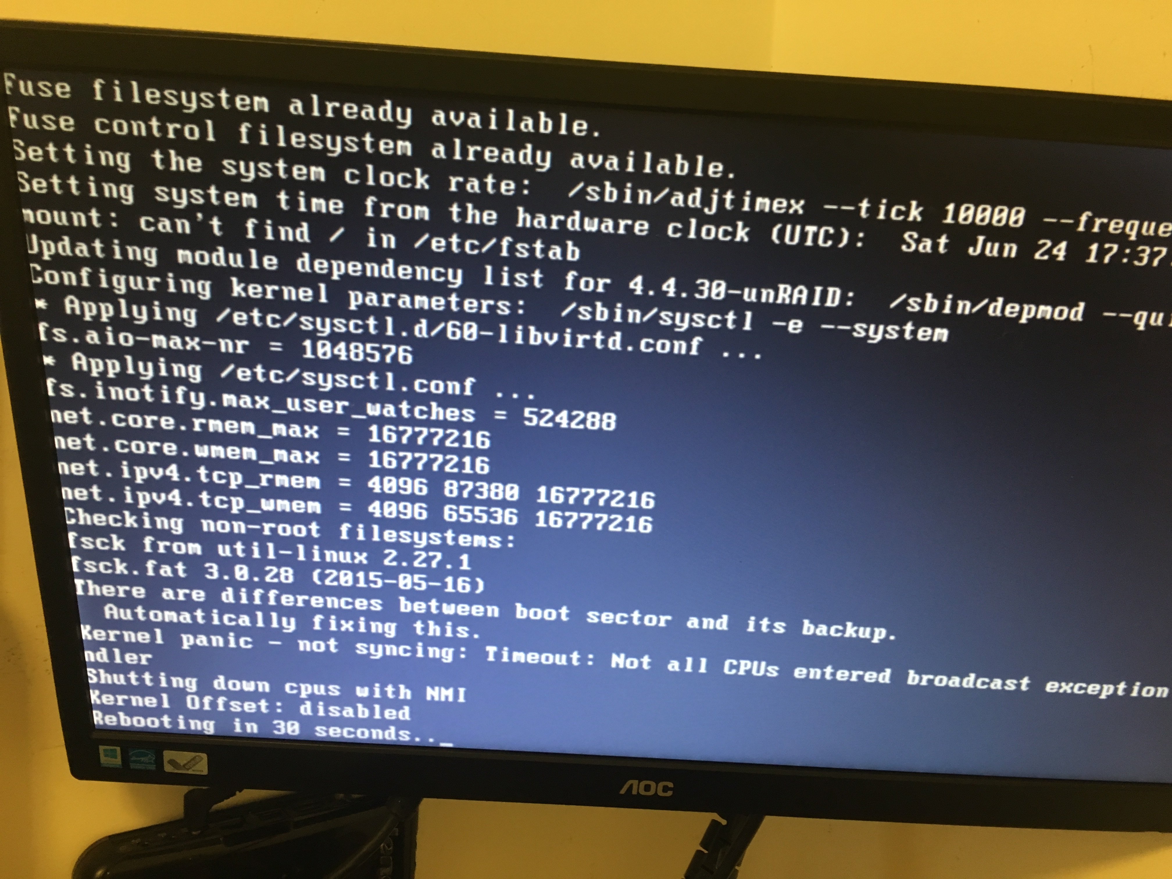

But I'm finding really hard to make it work, it's pretty slow on boot, sometimes it doesn't boot at all and when it does latency is crazy high. Network is optimal here, both router and mobo use GigaLAN and I'm using a short cat6 cable.
After many unsuccessful tests I've requested a unRAID 5 version to lime tech support, and that perfectly.  So they instructed me to post here to see if anyone could help up to find a solution for running unRAID 6 on my hardware.
I've made a video of the booting process, in this particular case the boot crashed and system rebooted. if that can be any helpful.
Thank's in advance.
Looks like a problem with the flash drive. Are you sure you prepared it correctly? Maybe try another port.

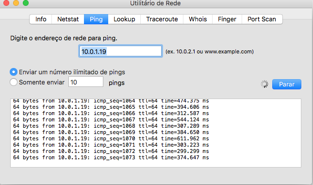

Now, after almost 15 minutes trying to boot, UnRAID finally booted, but is really slow and latency is crazy high, like the previous picture I've sent.

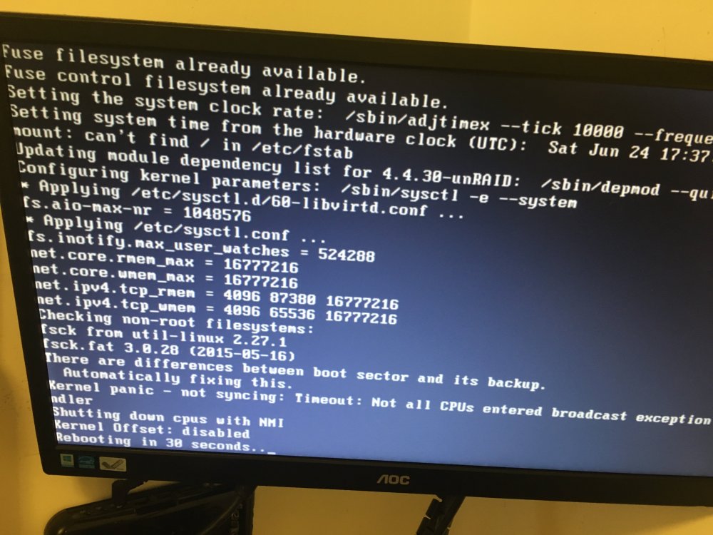

Yeah, I was really hoping that this would work. I'm getting this now:
