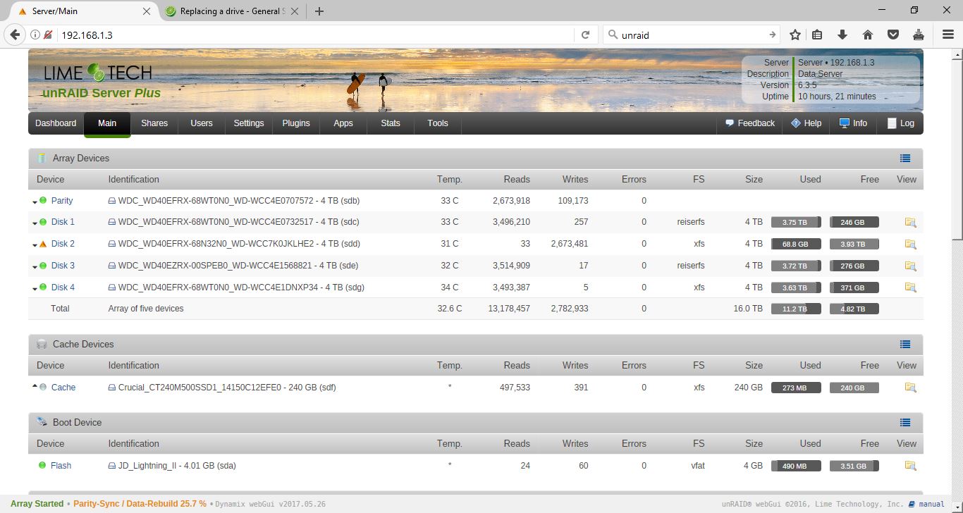

So i replaced my last 3TB seagate drive with a new 4TB WD red. I just want to make sure I have done it correctly and if the write speed of around 30MB/s is normal
  1. Shut down
  2. Replaced drive
  3. Started up
  4. Formatted Disk XFS
  5. Pre cleared drive (no errors)
  6. Started Parity-Sync/Data-Rebuild
If I hover over disk 2 the new replaced disk it says "device content emulated"
Iv got a horrible feeling im writing to parity instead of disk2 being written too.
Hope I am wrong.

So it looks like the dialogue screens confused me.
The drive has yellow warning symbol. Can I just stop everything. Put the 3tb drive back in. Create parity again.

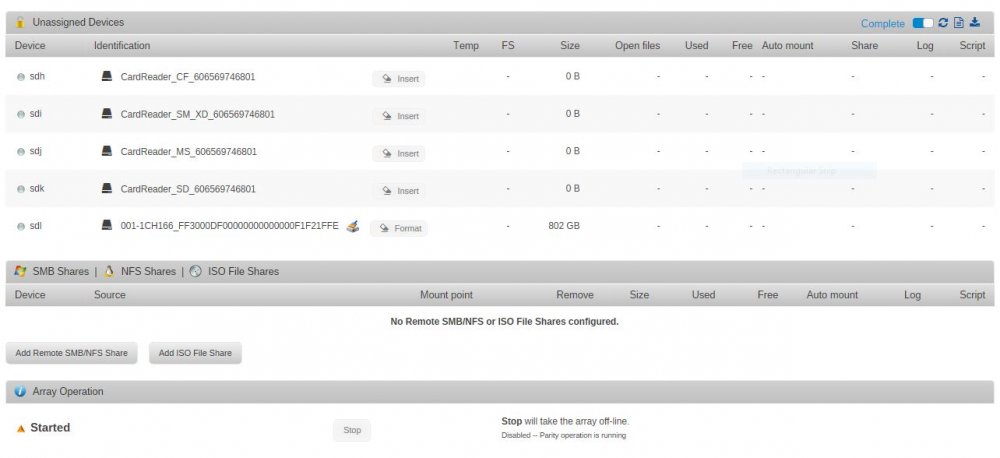

I have rescanned UD it shows the drive plus all the card reader slots but no idea on how to mount that.

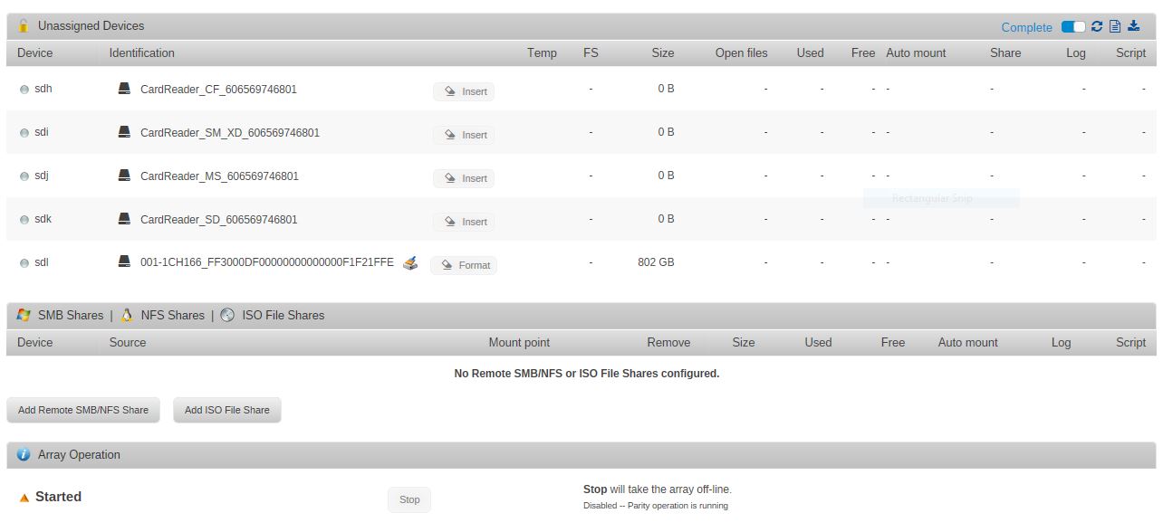

How do I mount the Disk from the USB dock, it appears the only option is to preclear? Probably best of disconnecting that for now.
Looks like the dock is not >2TB capable.
