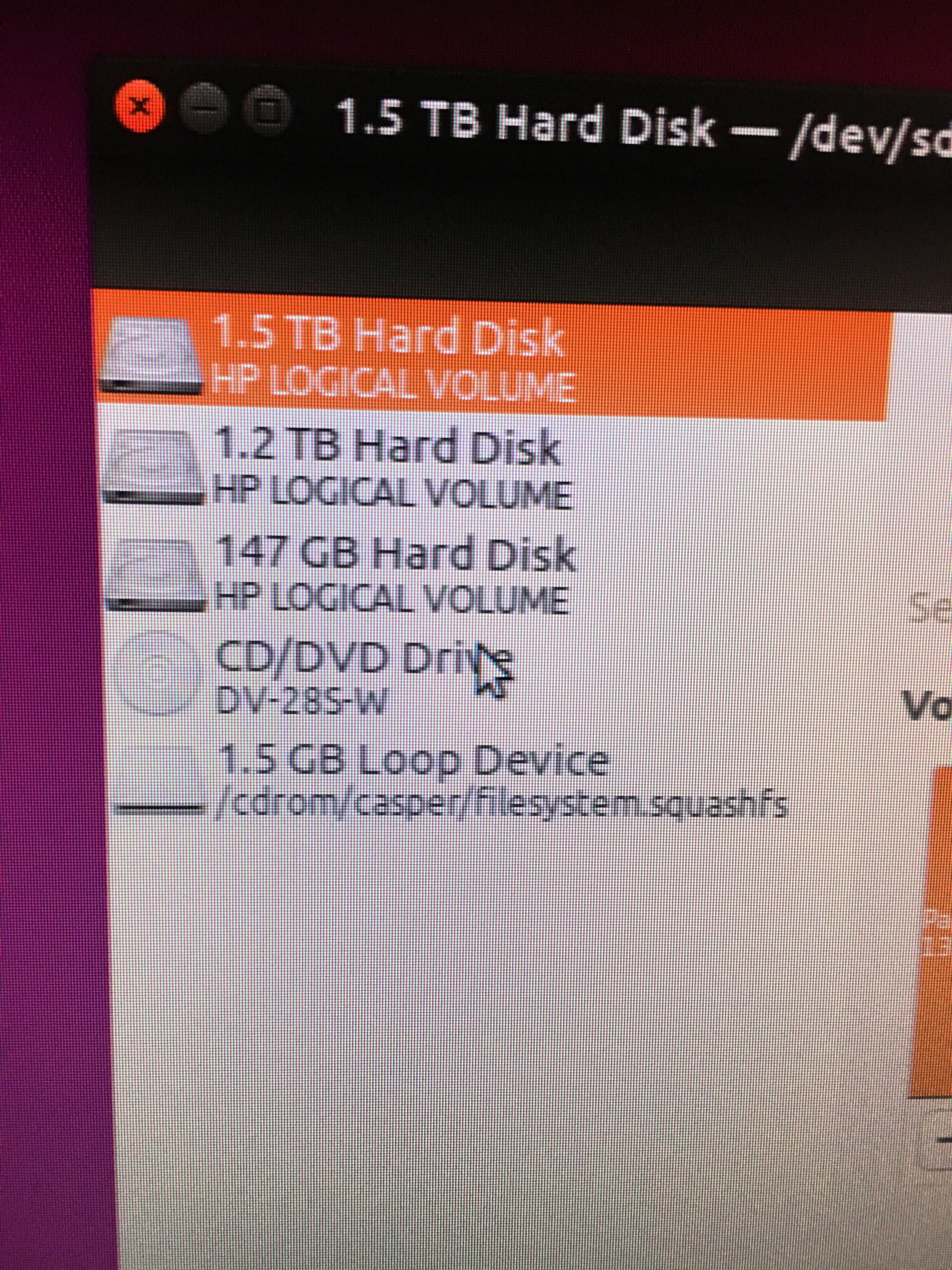

July 30, 20179 yr Author ubuntu 16.04 run on a live cd recognized the raid volumes from both controllers with no problems. Definitely an unRaid not liking the card problem. And I'm unsure if the resolution.
