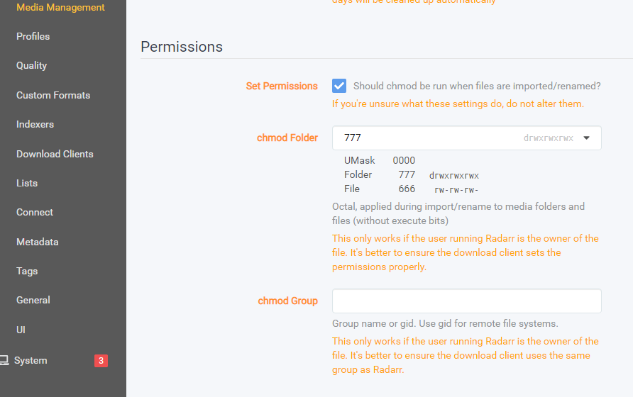

August 9, 20179 yr What are the proper values to assign for file, folder, user and group that aligns with what the 'New Permissions' script does in unRAID? For chown, do you use 99/100 or nobody:users? What values for chmod? Edited August 9, 20179 yr by johnodon
August 9, 20179 yr Author Answered my own question (I hope). This is what I am using and seems to setting perms consistent with newperms. If anyone sees issue, please let me know.
August 16, 20179 yr Mine is set up the same way as above, but instead of nobody / users I went with 99 / 100. Same result.
