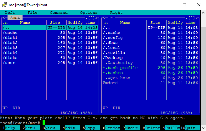

If I've read what you wrote correctly, Squid...there should be a user0 listed under mnt. I honestly don't remember ever seeing that user. Here is what is what is under mnt.
You don't have /mnt/user0 because your use cache setting is set to "No", change it to "Yes".

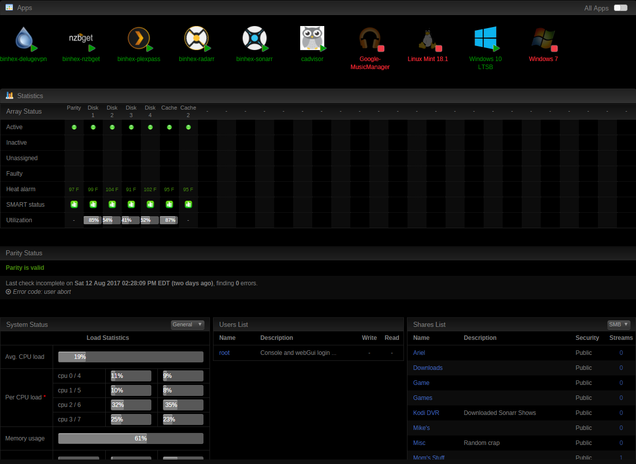

New issue....now all my dockers (Plex, Sonarr, etc.) are now no longer operating correctly. No WebGUI's working.
Do I need to reinstall all my appdata stuff?
I'm assuming that the apps are appearing within the docker tab.
Wouldn't be a bad idea to post up the following:
  • A screenshot of the docker tab showing the apps and the various mountings, etc.
  • The log's from the a container.
  • Another set of diagnostics.
But, push comes to shove, with everything that happened on the cache drive, it really wouldn't surprise me if you're going to be forced to start the appdata over again from scratch (unless you've got a backup).  But lets see where the above takes us.

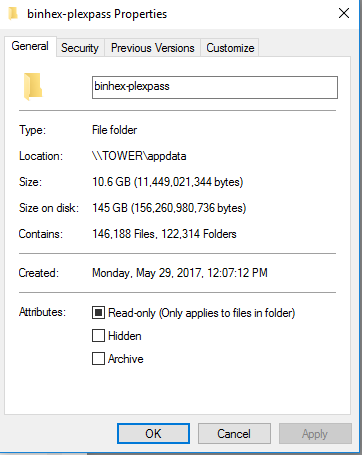

Don't know how big your collection is, 150GB doesn't sound right for plex. For comparison my plex data is about 5GB for 2000 movies + 1000 episodes.
I'm not sure how SSD's differ from HDD's in allocation, but the combined metadata of Plex, for me is almost 150GB, at least when Windows is looking at it.
Since I'm stuck with 256GB SSD's, do you think a JBOD cache would be a better way to go?
That is not a case of allocation for SSD vs HDD, it is just a case of Windows assuming an incorrect allocation size over the network... 1MiB IIRC.

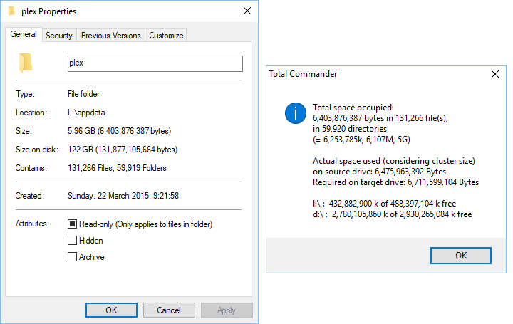

Windows isn't calculating the disk size properly. Below my Plex folder according to Windows and Total Commander.
