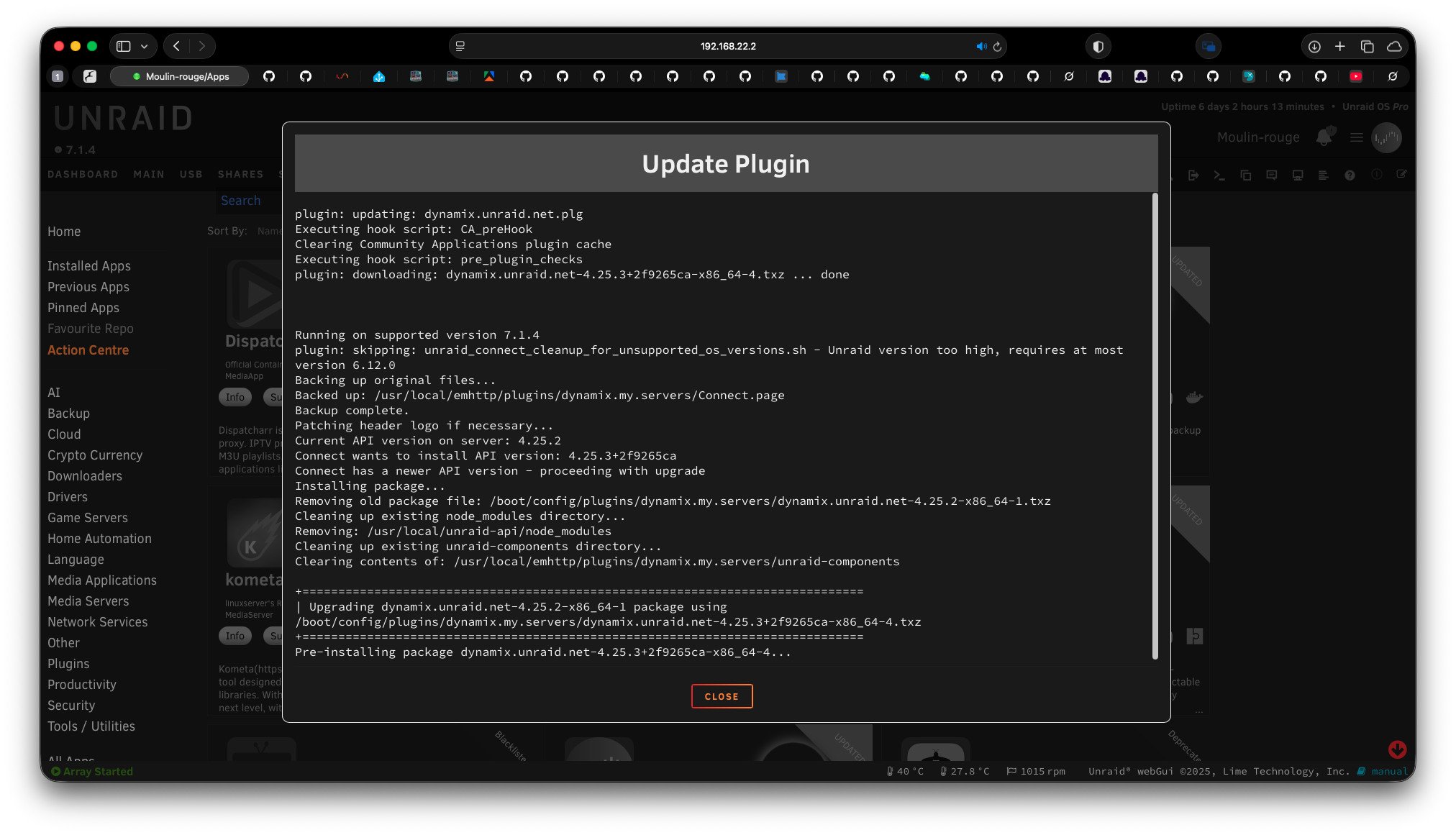

October 22, 2025Oct 22 does this show up when for example it shows code during container updates etc? Edited October 22, 2025Oct 22 by dopeytree
